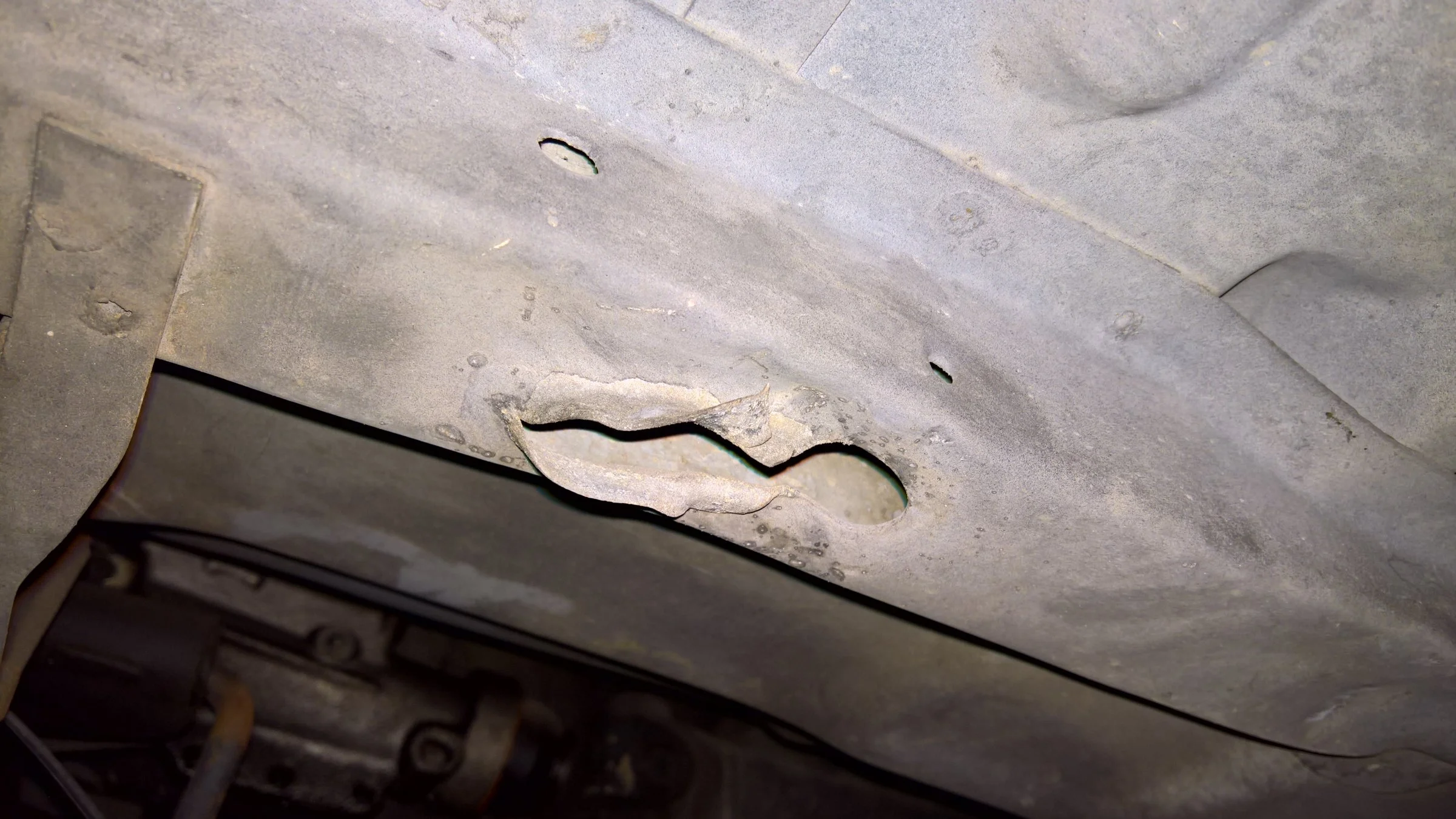

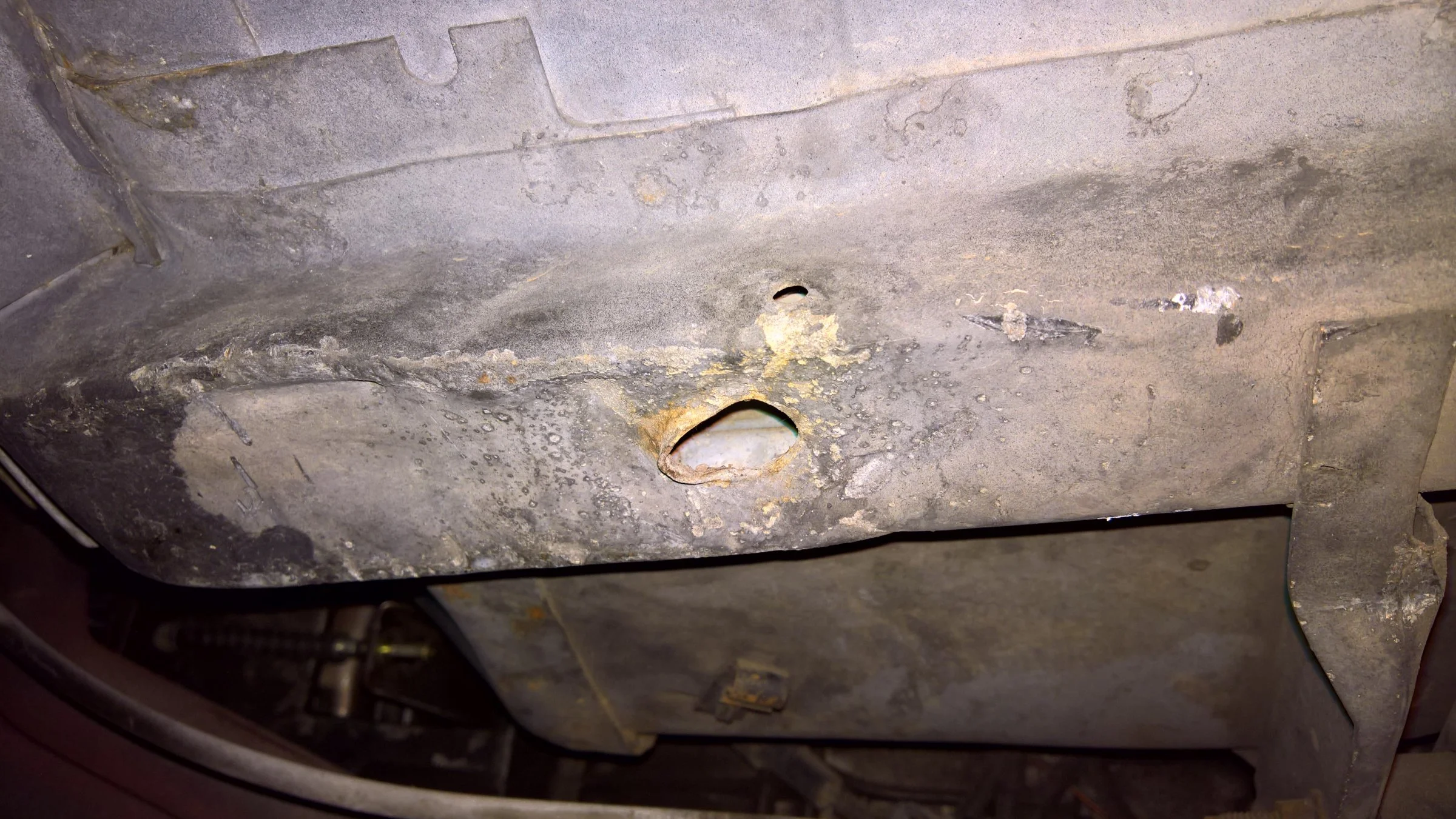

So my driver side front subframe is kinda gouged in two spots...
Question is... Will a shop have a hard time getting this fixed so I can install the MM full length connectors I just bought? Contacted MM and they recommended GTR High Performance in Rancho Cucamonga. Far drive for me but I wanna make sure I take it to someone who is gonna do it right.
Gonna give them a call tomorrow and also get these pics to them but wanted to get the opinion of you good people first. Thanks!!!

car needs to be at ride height with the suspension loaded when youl weld up the SBF or you will have a welded in tweaked car. Makre sure all weld points are clean and shiny and then spray them with etching primer and some VHT paint. while you are at it. you may want to weld up the lower torque box seams.
