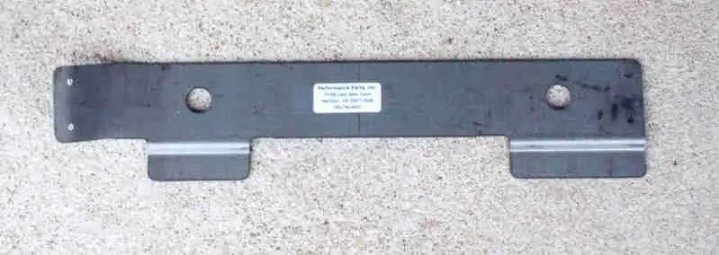

That is a very common problem buy a set of subframes with seat braces and you can also find a reinforcement panel that was put on verts and ssp's to weld onto it also just grind down your cracks and weld them up first
Yep, mine already had this brace but the floor still cracked on the rear left side seat bolt hole.
Some fat ass must have owned the car originally. :shrug:
