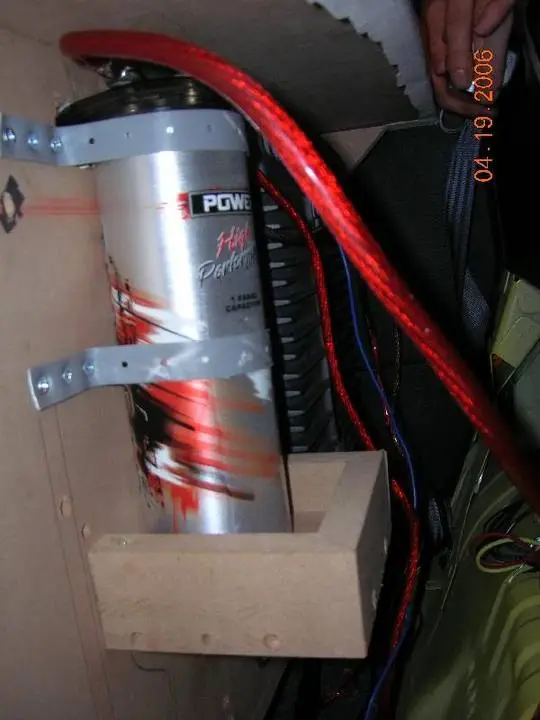

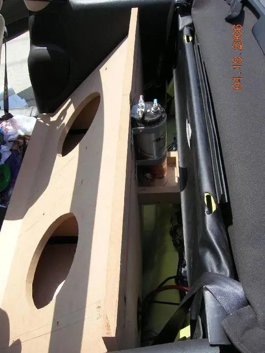

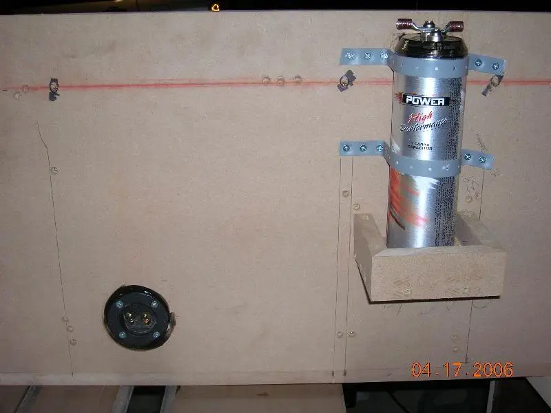

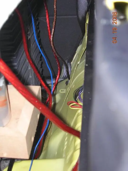

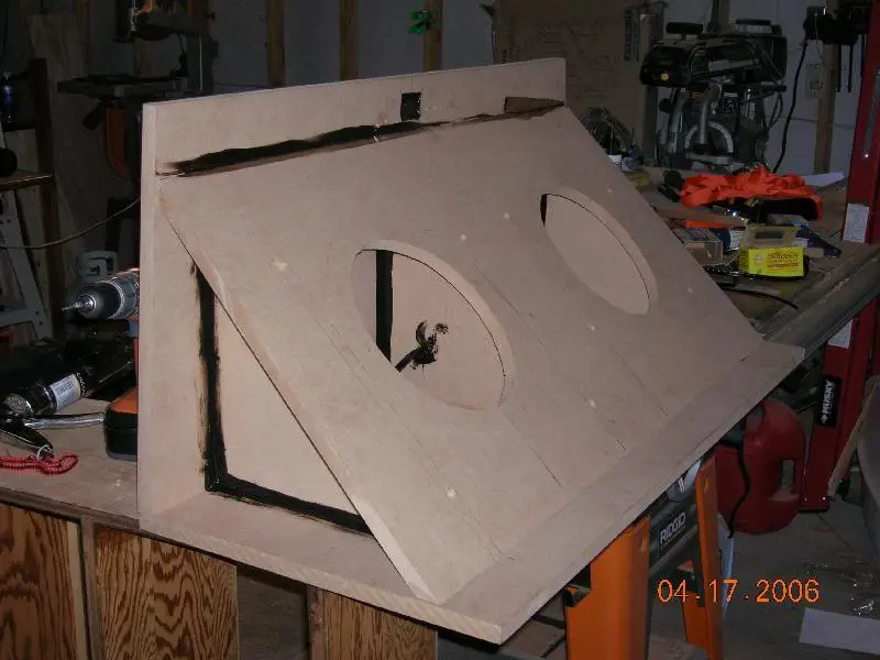

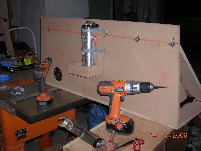

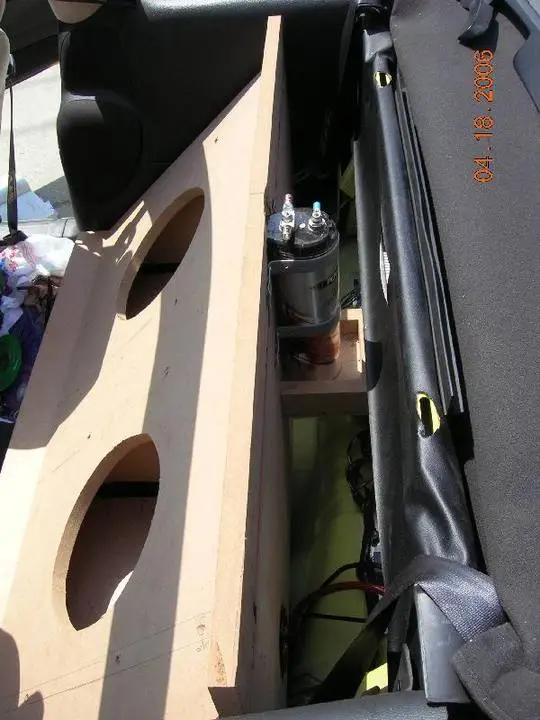

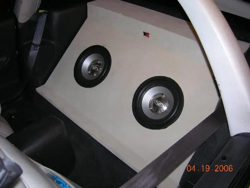

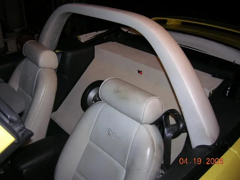

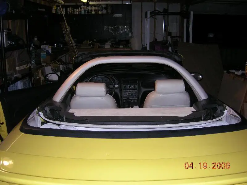

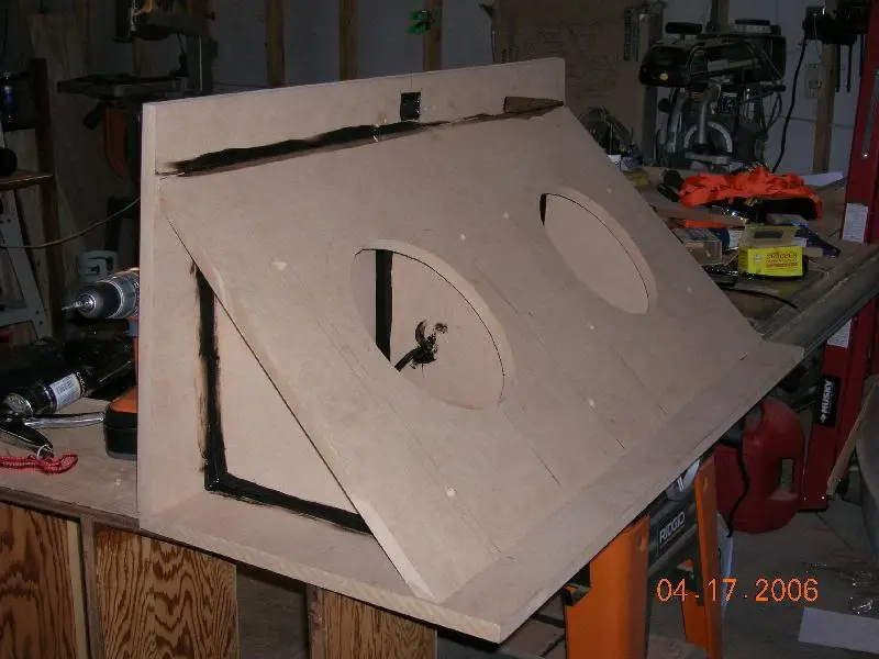

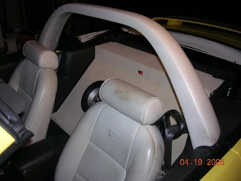

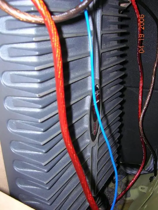

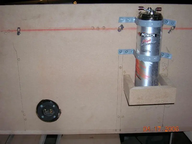

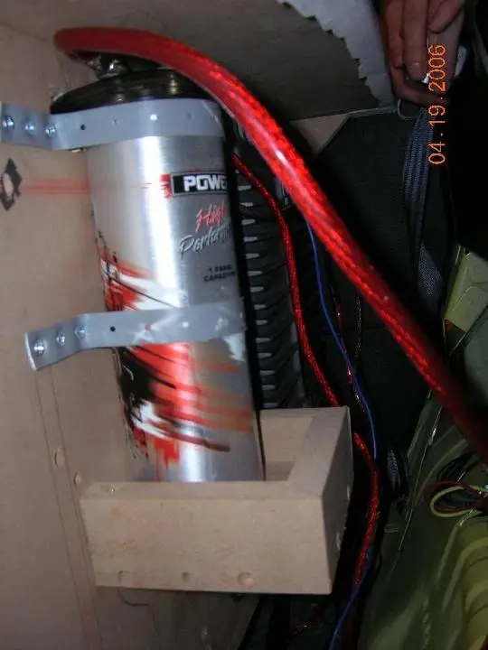

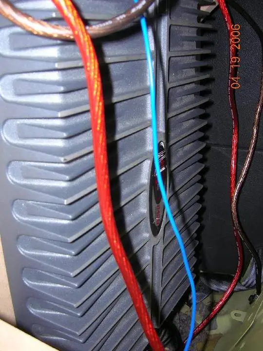

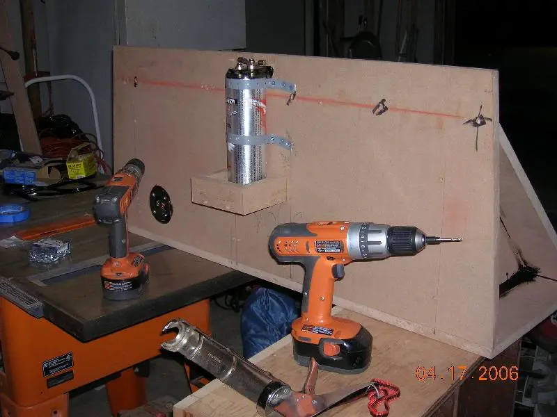

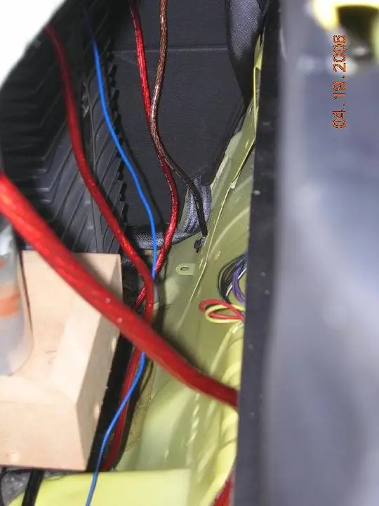

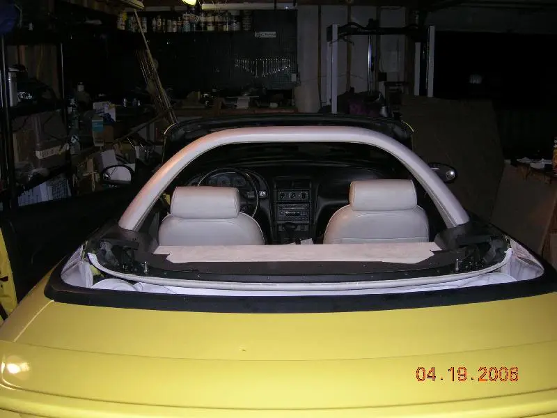

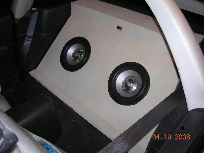

What I did was remove my back seats and custom built a box to replace my back seats with. It took me an entire 2 days to complete this project - and i'm a very experienced woodworker. If you don't like this idea just go with the trunk. Make sure to put some dynamat (or the like) in there though, or else it will sound like crap.
Here's some pics of the construction process
and this is what it looks like behind the box, where i have everything hidden
