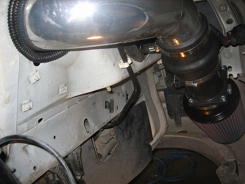

Also, I'm running 4" pipe/MAF in my fender, no fitment issues.
My routing is different than yours, but you can get the idea of the layout:

Did you need to remove the fender to attach that Pro-M meter?
On the MAF, I removed the tire and the fender liner - you can do it by just reaching up into the fender from below but I would rather just pull the liner and save myself the hassle of trying to fish around in there.
