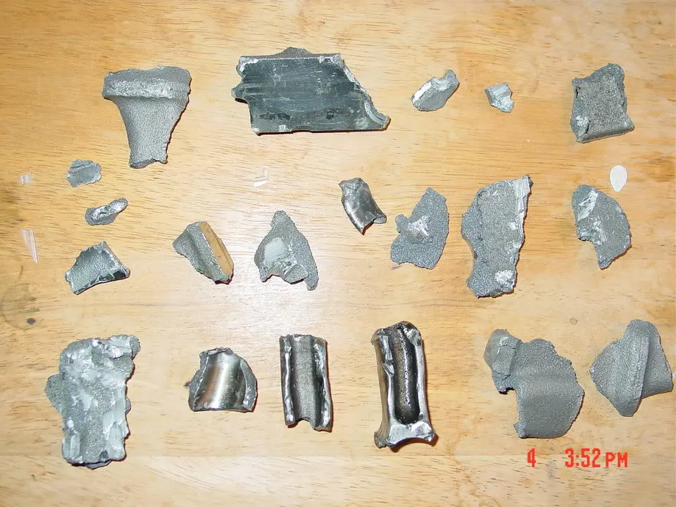

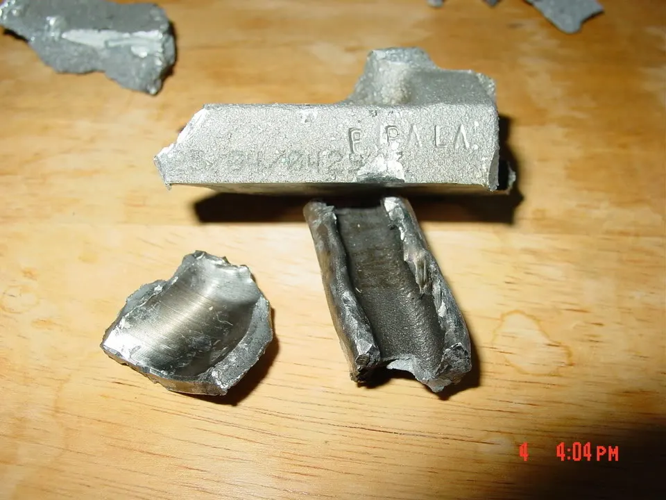

This is what happens with boost + Nitrous and no tune. With a good tune and 8psi you should be fine. However your engine wasn't designed for boost so someday it may pop. just start saving for a new short block sometime soon just in case.

The stock powdered metal rods just like the ones in the 96-01 Cobras and 96-06 GTs are the problem. Those rods could fail at 400HP at high RPMs
The reason those rods flew apart inthe pics i posted was because of detonation.
It's all about the tune man
