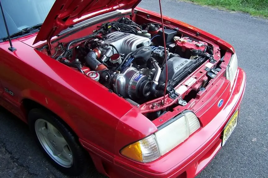

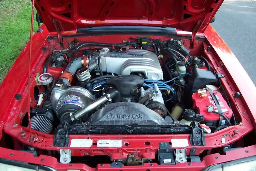

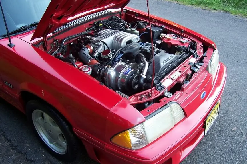

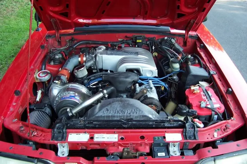

I went with an older Paxton SN 89 ball drive....
I have a 3.75 pulley on it and get 8 psi. No dyno #'s yet. Its self contained, easy to install and CHEAP on ebay (under 1000) and you can rebuild them yourself if it goes bad ....
