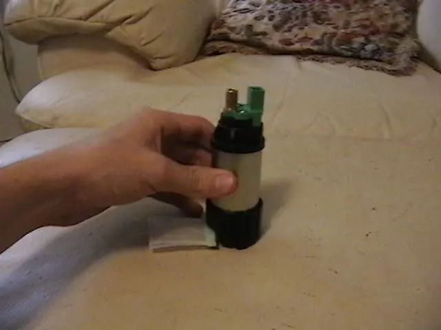

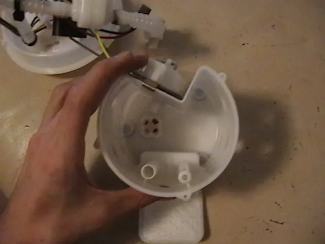

Ok here is what I posted in another thread....seems more needed here though haha.
Ok here is what I did to my basket....shouldnt drain the basket now :lol: .
And the pump W/ its filter...and how it sets in the basket. No wonder the darn thing drains the basket in stock trim.
:eek: Thats some big holes! I know you have probably done a little more reading into it than i have, but do you think thats too many? With that many holes, how full do you think you'll have to run your fuel tank if your going WOT so it doesnt drain quicker than it can fill up again? I would say like 3/4 tank to be safe, so i doesnt drain out.
Is that the best place to drill those holes, one of the threads i was reading on m-depot said to drill a couple in the bottom of the basket and you would be good to go. So confusing...
(wierd, this thing astericks out if i put the name of another forum, odd)
I doubt it....its setting on the bottom of the gas tank...you would literly have to push all the gas to the other side to make the section empty. In the case if the stock basket, it relys on pressure to push gas up from the bottom...if it got that low, the fuel pump would quickly drain the basket and there wouldnt be any pressure to push fuel up into the basket anyways :shrug: .
I see this modifcation as a huge improvement. It would require the fuel to get very low before it go lower than that bottom hole, even in a turn or going WOT. Then sloshing would be filling the basket fast with the holes there, yet it still is able to maintain fuel in the bottom of the basket, and the hole in the bottom will trying to fill the basket right under the pump.
It shouldnt starve at all above a 1/2 tank.
And should be fine for staright line down to around a 1/4 tank, but I wouldnt try it :D
