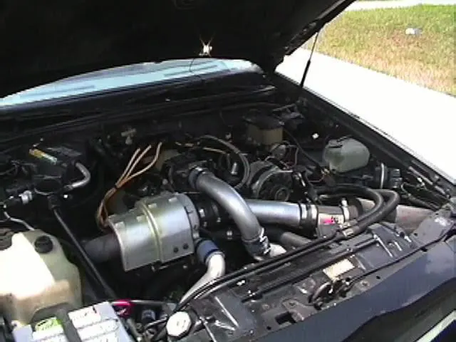

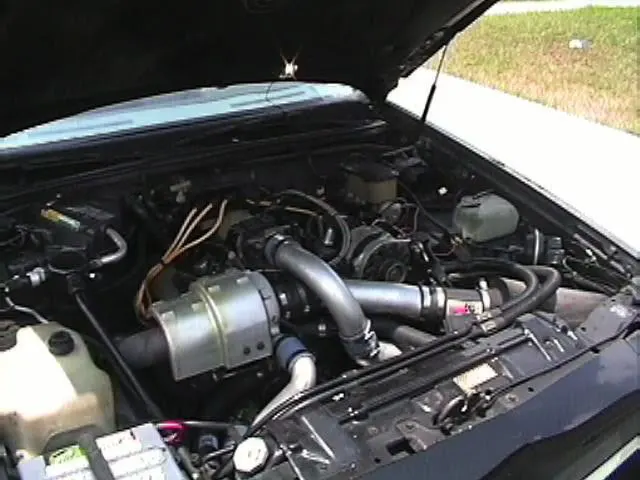

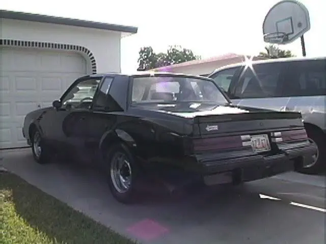

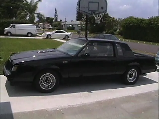

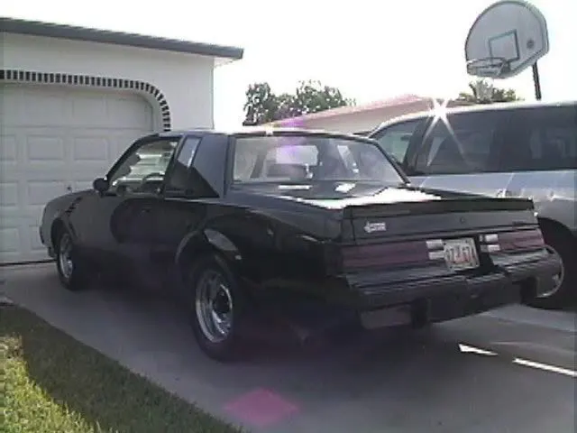

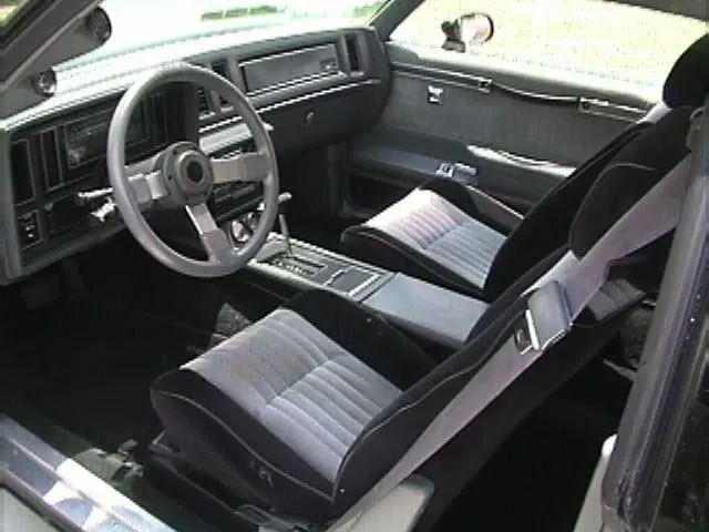

Turbo's seem to be really torquey all the way through the RPM's, seems to be more strain. I owned a 1986 Buick Grand National back in 1999 and even as heavy as it was the damn thing would throw you back in the seat. Also had a TE-44 Garrett blowing 21psi and 3" down pipe. I also blew headgaskets twice with my Vortech on the 94. That was because I got greedy with the boost 12psi pulley was making like 14.5psi. Main key with any type of power adder is getting it properly tuned. My Grand National made 500+HP on a conservative dyno tune.
