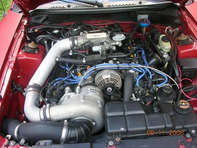

here are some pics
Hunter

Hunter-Be careful. I see the car has a FMU on it to add fuel pressure along with boost or whatever, but I also notice the car has stock 19lbs injectors!!! I would NO WAY run blower with stock 19lbs injectors! Somepeople do, but I wouldnt touch that! Check to see if the owner has any type of dyno numbers or tune iunformation for the a/f ration and all that stuff. You should upgrade that fuel system right away! Does the owner know how long the blower has been on the car?
