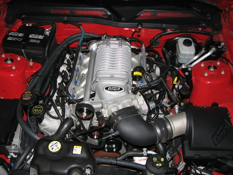

Threw a magnacharger on my 05 YEARS ago and now my son still drives it like he stole it. (He bought it from me!) It has maybe 50K on that setup and still runs like a champ. She was a manual, so I'm not sure about your auto tranny needs. The manual with the blower chewed through the stock clutch in about 10k. The second in about 3oK. She's got a heavy duty aftermarket now. If you have the means, drop the blower on you'll smile every time you mash the gas.
