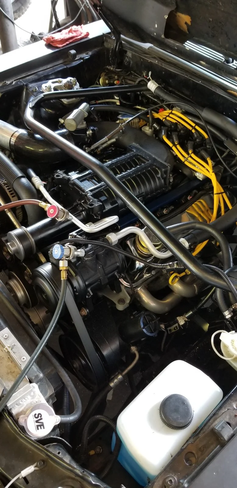

You had a 5.0 with a M112 huh? Custom job, I have one as well. Was yours a joeystang monstrosity? Lol. I made my own setup.
Nope, not sure who joeystang is lol. Kind of did a junkyard build up. Cut part of a jaguar blower off and mounted up top as a pusher. Did it after i seen Alexltd i believe his name was on other forums.
I see you're running a Jag blower as well. Good stuff. I wanted mine mad max-ish lol but that was 6 years ago i think? Have no idea where the car is now, i was going to use a termi blower on my svo but never went through with it. Might do it to my saleen some day but with a whipple.
