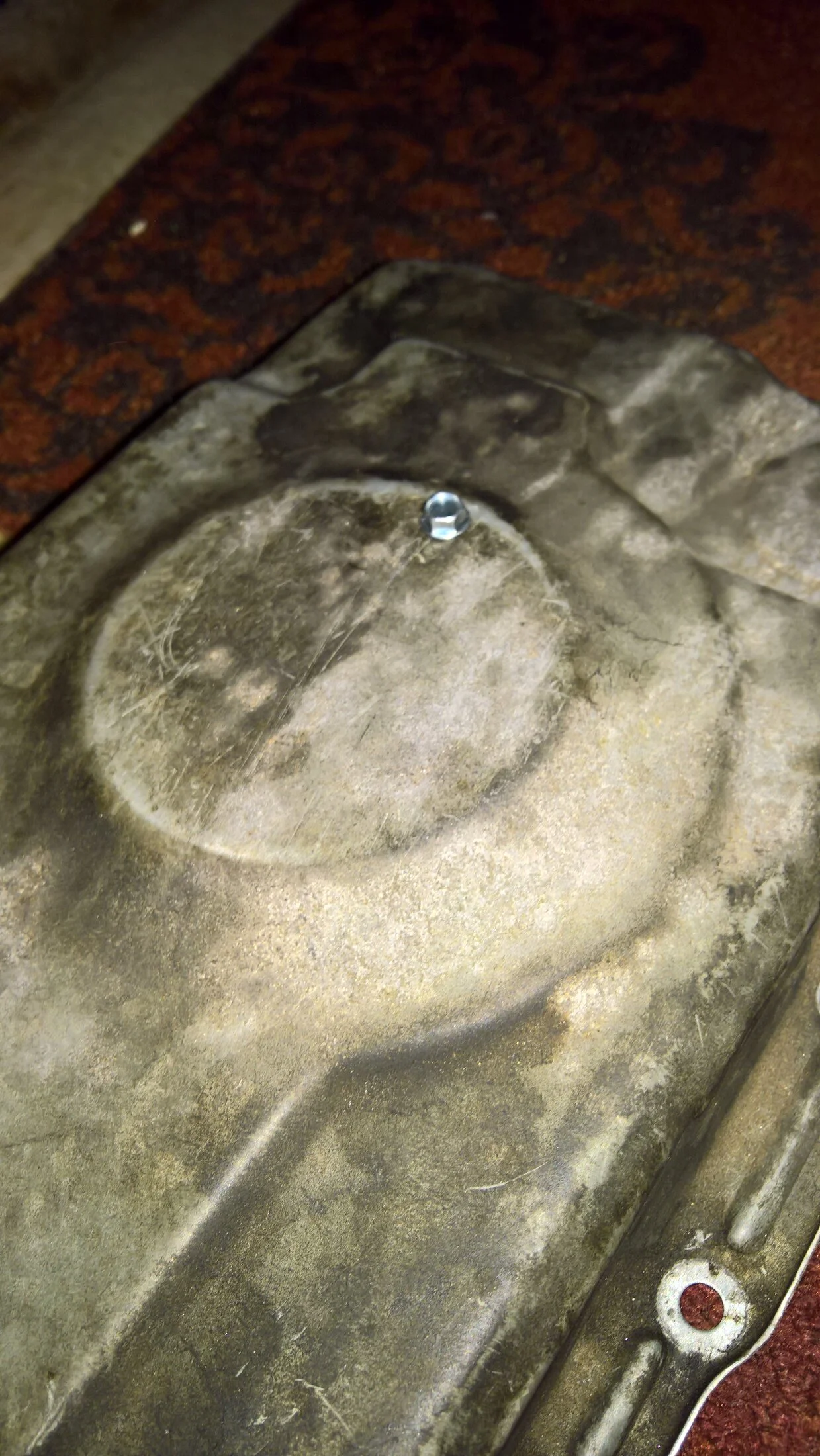

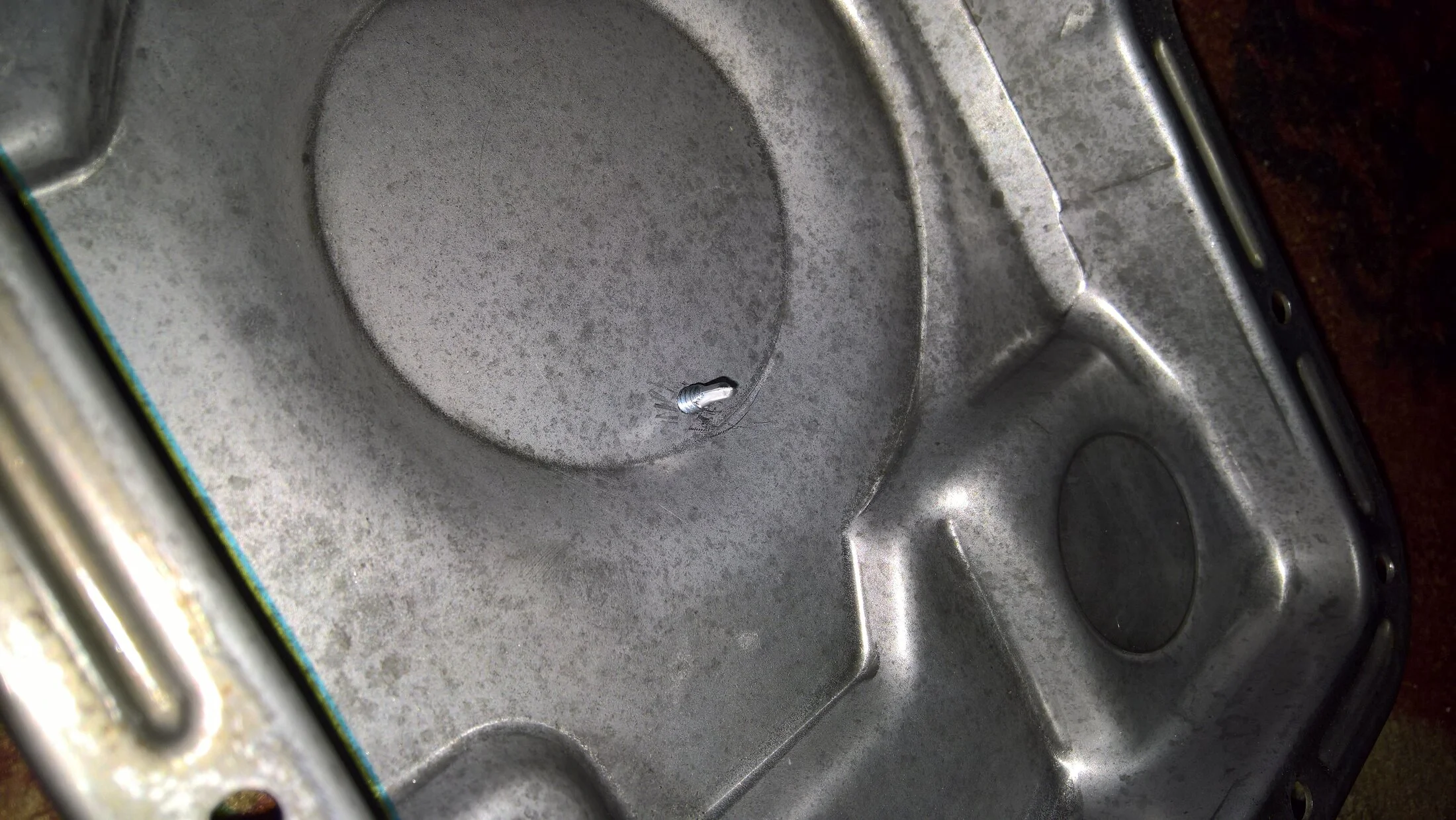

Success!!! I rode the Dyna to NatPro and picked up the TransGo shift kit. I didn't find any broken springs when I installed it so I didn't hold much hope. Unfortunately, after a final cleaning, as I gathered everything to reinstall the valve body, the tiny spring-clip that goes on the Z-link was gone. I searched for hours but couldn't find it. Apparently, as Murphy's Law for mechanics says, it disappeared from the face of the earth. I went to a Ford dealer and several trans shops but no one had one. After almost a week, I finally went to an LKQ Pick-Your-Part. The only vehicle they had with an A4LD was a 93 Aerostar. Due to all the rain we've had here, it was sitting over a small lake of at least 3" of water running the full length and width. Not wanting to lay in water, I rolled several wheels with tires under it to form a sort of platform, and found a panel and some carpet to lay over the wheels. The staff at the gate told me they drain all fluids. Once underneath, I saw that they do that by punching a hole in the pan, so I won't be looking for any used pans there. It was slightly messy because there's still some fluid, but I got the clip. I installed the valve body yesterday, then looked for a suitable place to put a drain plug, using a suggested inexpensive method posted by a trans shop on YouTube. There isn't much room around the valve body so I chose slightly to the side of the bolt head holding on the filter. Rather than measure twice, cut once, I measured 5x, cut once. I included pics of the result. Today I filled the trans with fluid, and lowered the car off the jack stands. I brought my son out because he wanted to do the test. I fully expected it not to work and envisioned the hassle of replacing the torque converter. I was shocked when it dropped into gear and idled fine without stalling. It moved forward and backward with no problem, and my son drove it to pick up his mom and it drove fine. This is one time I am happy to be wrong.
