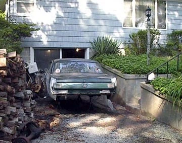

oboebrian said:
Great job.. but where are the picture man!
here's one.............
attachment.php
When you put the new bolts thru the new bushings, you might want to coat the bolt with some axle bearing grease or some never sieze, it might help to keep the bolt from rusting to the metal sleeve in the bushing if you ever have to remove it later.
Also, use never sieze on the bolts.
RM: Thanks! Removing the axle was easy, just four quick cuts on each side with the angle grinder, although I did have to shift it ~18" to clear the wheel wells when I rolled it out. The springs also got the treatment with the angle grinder (she was REALLY burning rubber when I cut into the bushings!:lol: ), then I took the sawzall to the bolts........

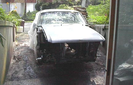

attachment.php
