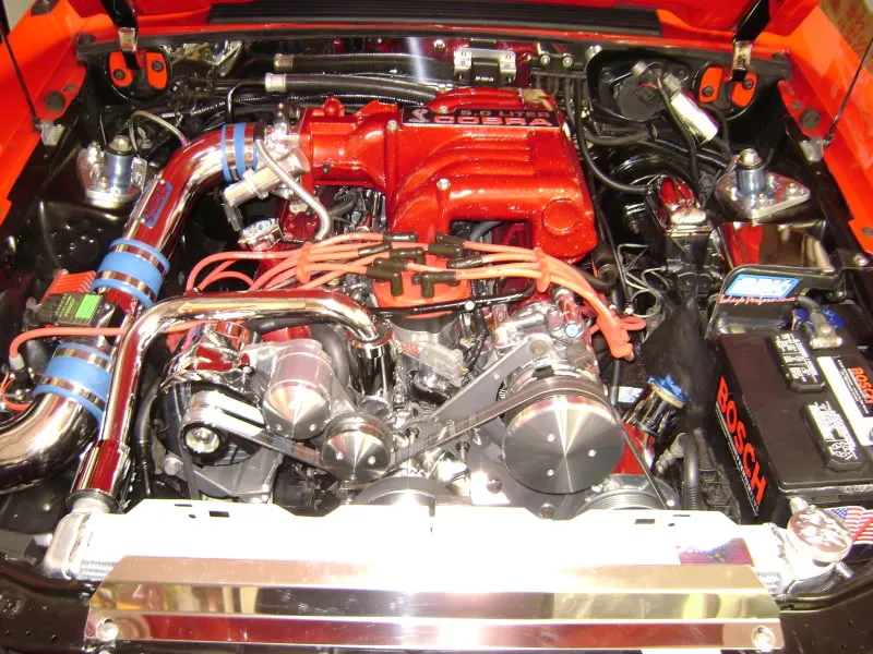

I don't get too surprised anymore when I dyno my customers cars, I always have an idea of what for power they should make, but the 333ci I just finished really impressed me and I wanted to share.
The combo I felt was going to be very limited since my customer had a very nice custom powder coated Cobra intake that he needed to keep. The combo is for a Show car that see's street duty, so drivablity was #1.
Here's the basic combo...
333ci 10.6:1compression (3.25" stroke, 5.4" rod, .040" bore) stock block based
Stock unmodifed 93 Cobra intakes, with a .5" spacer
70mm Accufab
30lb inj
75mm PMAS bullet
BBK cold air
AFR185 PT#1422 v2 (new style), 1.6 rockers
RNH Performance Custom Cam, hyd roller .550/.570 (My first true custom designed by me, ground by COMP)
1.625" BBK long tubes, full exhaust 2.5"
Full front accessoroes
On a Mustang Dyno it made 360HP/380TQ to the wheels, peaked at 5300rpm! This particular dyno is very conservative and on a Dynojet I would expect it to make 400RWHP....I was totally shocked, and very impressed. The TQ curve is similar to a big inch motor, it comes on low and strong and the car feels like a monster. I'd love to slap a RPMII or Holley on it and see what it makes.
Just wanted to share ;) :nice:

ive been having too much fun to post heres the latest i just got back from a little ride finally cooled down here car temp never went over 180 so i took some liberties WOW!!!! i finally put 3 gears together my back is frigan killin me still only got around 600 miles on it Rick i think its gotten faster especially with that good air tonight god dam monsta i gonna have to keep my PBA card on my lap looks like it draws alot of attention, cant believe im saying this but your right we'll put the nitrous on the back burner:D RNH POWER :hail2:
heres a pic from the garage gotta get one with the sun shining on her big difference!!better pics comin
Thanks EPIK i wasn't gonna put up any pics till i got some outside shots the intake has a sparkle that turns on like a light switch with the sun on it looks just red in that pic, plus all chrome and billet looks better with natural light. Never could be happier 2 nights in a row with hardly any sleep now after the ride i just had im ready to go back out sucks cause i'll wake the house up and all the neighbors too ah i'll wait till tommorow:D

Wow, that is one nice looking engine mang :nice:
I wasnt sure I would like your intake when you first had it done but now that its all together I am really digging it :nice:
