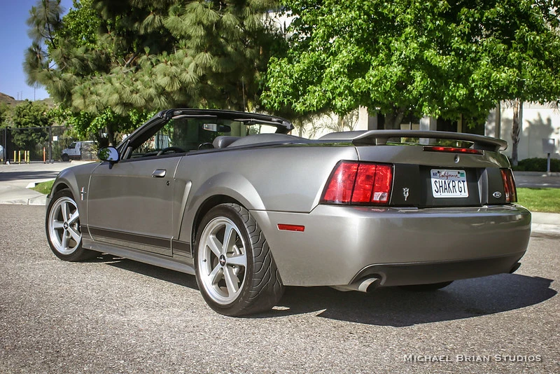

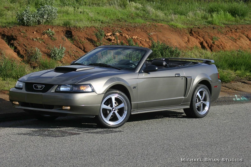

I no longer own the car, but here are a few comparison pics:
Stock:
Lowered on the Ford Racing G Springs. To me, it was the perfect amount of drop. I would occasionally scrape the lower chin spoiler, but only on really steep inclines.
