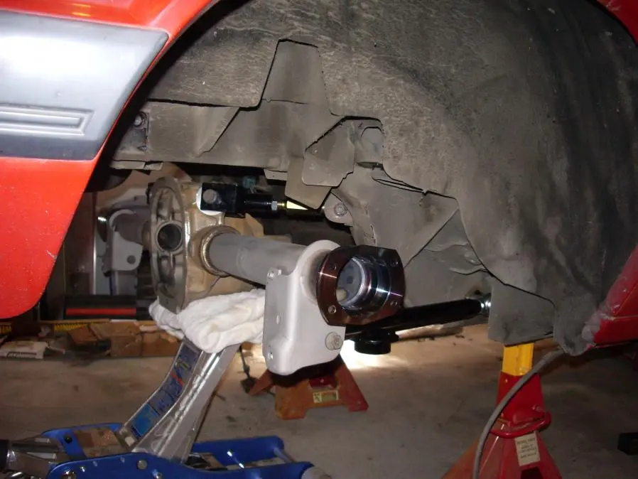

1st pic; TeamZ double adjustable uppers, lowers and spherical bushings prior to mock install.
2nd pic; mocked up
