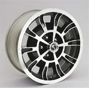

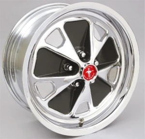

Thanks for the advice. Would there need to be any modifications made to those recommendations if i were to go with a larger wheel such as 17's with a lower profile tire?
There are also plenty of 17" wheels that fit properly without spacers. Here's a couple:
Don't limit yourself on tires to little 15s althought tires are a lot cheaper...
Go with a 16 or 17 inch wheel. 6 cylinder or not, the more rubber on the road the better you'll be able to do.
