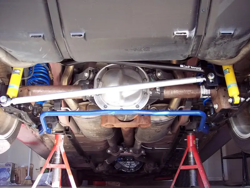

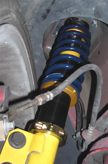

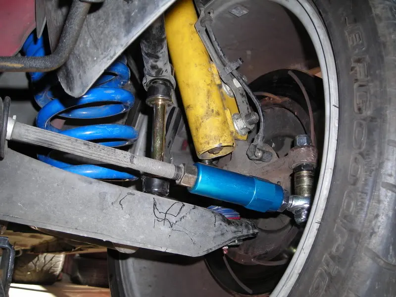

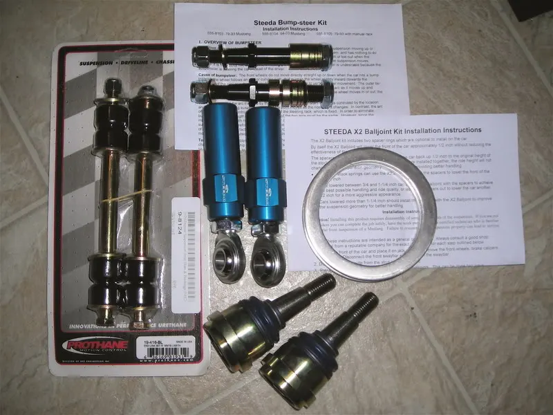

Here are a couple of pics of my suspension setup...These were taken when I still had the stock exhaust & subframe connectors...rear coilovers & torque arm should be going in shortly (was supposed to go in a long time ago, but things came up)....
Front coilovers installed....
These helped out alot too....Steeda bumpsteer kit/ X2 balljoints/ poly swaybar endlinks...
installed, b4 I did the front coilovers....
