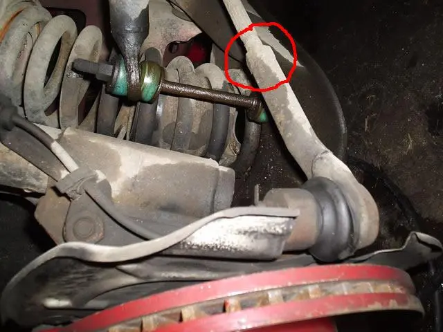

Is the bolt circled in the attached picture supposed to be loose? I was under the car the other day and I can turn mine by hand...I'm not a suspension guru so I'm not sure what it does/if it should be tightened one way or the other :shrug:
No, it shouldn't be loose. It's just a jam-nut for the tie-rod end. Someone doing an alignment who needs to play with the toe-angle will loosen this nut and turn the tie-rod one way or the other to get the desired toe and then re-tighten the nut to lock the tie-rod in place.
If it's loose it's likely someone didn't tighten the nut or didn't tighten it enough. Get two wrenches, one to hold the tie rod and one for the jam nut. Hold the tie-rod in place so it doesn't turn and tighten the jam nut.
You might consider having the front-end alignment checked in case the toe for that wheel has changed. You might notice the steering wheel is off center, the tire wears in a feathering manner, the car tracks oddly or there's tire squeal going around corners, even slowly. If you don't see any of these, the alignment is likely correct so just tightening the nut is all that's needed.
Had any front-end work done lately?
I figured it wasn't right for it to be lose. I did have front end work done lately and my car is not steering straight. I'll go home and tighten that bolt up like you suggested...Then I'm gonna give the shop that did my alignment last a call and have them align it again. Thanks for the quick response!
