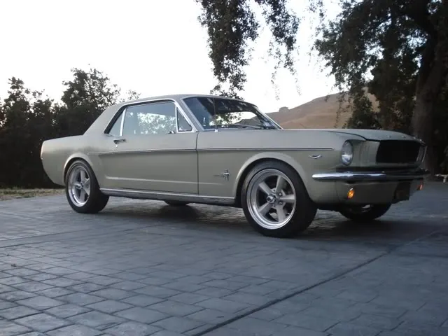

I have a '65 and want to start working on my suspension. My goal is to eliminate the original soft suspension, under-steer, and the sagging rear and get a firm, level ride. As for the under-steer, I would rather have over-steer. This will be for street/track use. I need some recommendations on good springs, shocks and leaf springs. I also need to replace my upper & lower UCA. Stance is very important aswell. I like how the rear sits, but would like to drop the front ~1". I also need some info on how to get rid of the under-steer. Here's a pic. of the current stance.

I got 4 leaf reverse eye springs for the rear, and now sits at least an inch higher than the stock 40 year old sagging leafs. But it's OK, 'cause it might settle a little and I now have room for a little more tire/wheel.
For the front, I got stock replacement GT springs, but didn't want it to sit too high, since the new motor has aluminum heads, the battery is in the trunk and I have an aluminum radiator. So I cut one coil out before installing them, but now it sits way too low. :mad: Anyone ever use the spring spacers? rubber or aluminum?
