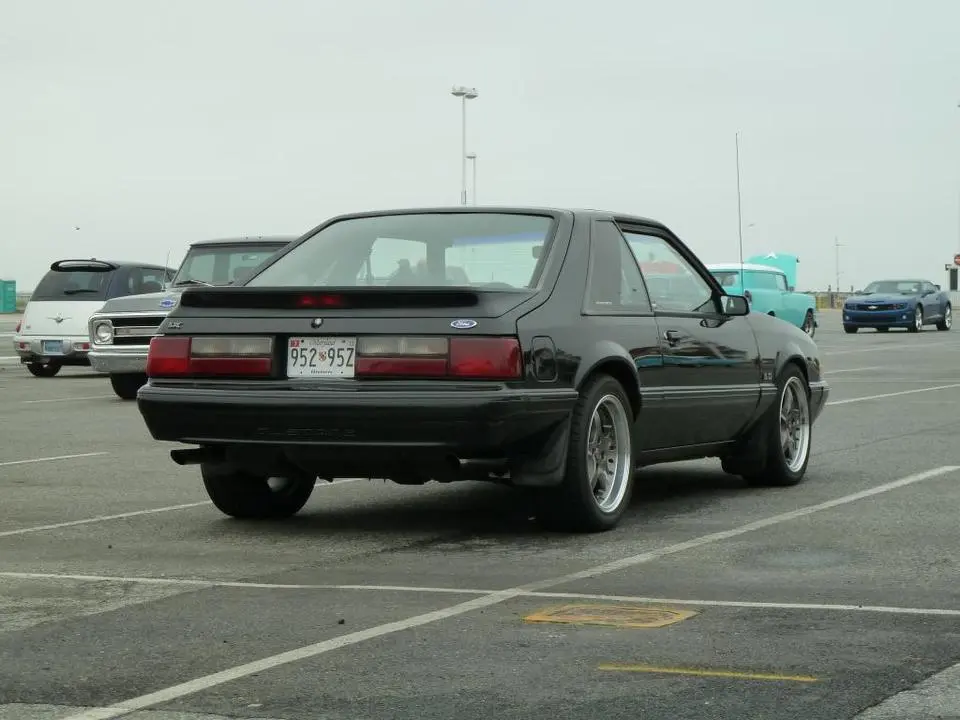

Everyone always slams it. Dare to be different and rake it. Leave the rear stock height and lower the front a bit.
I have ford racing 'B' springs with about an inch drop. I no longer have a fox by the way, just the 95.
Here is stock height rear and 1.5" drop front.
