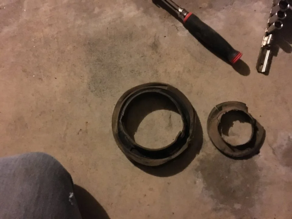

Replace the rear spring isolators while you are at it, Prothane makes them as well. Your old ones probably looked like the ones I had.
