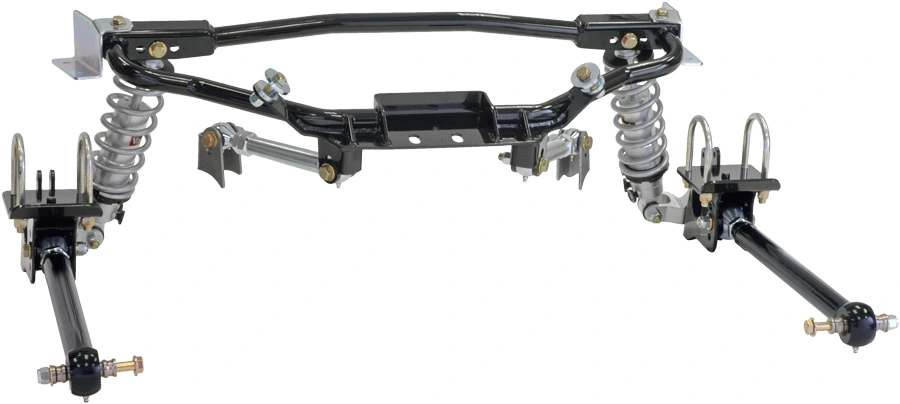

John, if you're looking at doing a 4-link system we offer a great triangulated system that has been proven at the drag strip and on the autocross. Our g-Link system has spherical pivots and will handle power levels in excess of what you currently have. It's a straight-forward install and will work with your stock rear-end housing.
Systems with polyurethane bushings and coilovers (g-Bar) start at $1798. The g-Link version starts at $2139. There is more info and a list of options here: http://www.totalcontrolproducts.com/gBar.html

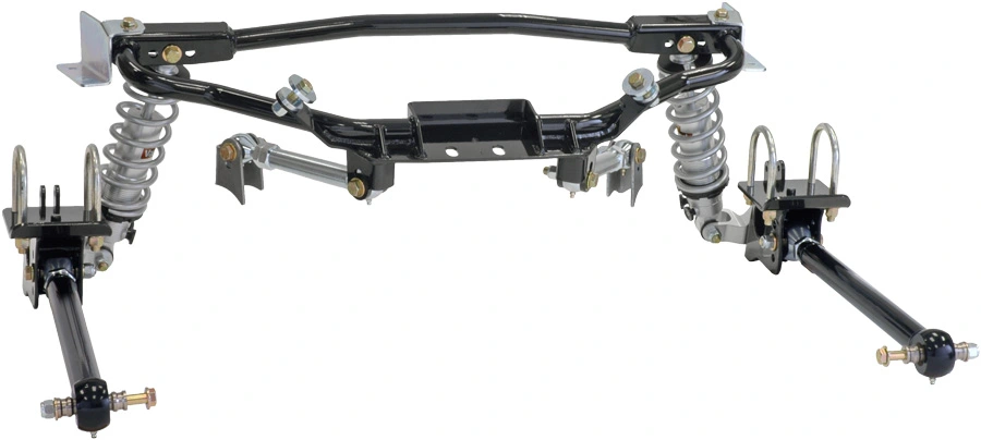

I'm waiting for the shop the finish the entire TCP system, front, and rear. Great stuff, but its a budget killer.

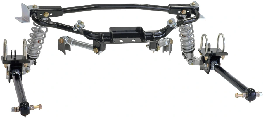

if you are going all out, then this is the suspension to get. TCI makes some great stuff.
