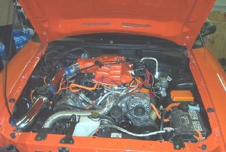

You will definetely need a new computer, as you will be switching from a return to retrunless fuel system. You may find that the fuel rail is the hardest thing to figure out, v6power and 3.8 mustang have a couple guys that make them, but they are like $250. I used a windstar rail and a intake spacer for my swap. The 2003 motor will also have the IMRC in the lower intake that you will have to remove and block off. Go over to v6power and check out split port swap and you will get all the info you need. I just finished putting a '99 motor in my '98 vert and it went pretty well. I do have about 70-80 hours labor in it!
Yeah, I have a lot of time involved, but I tried to "detail" everything as I went. I also haven't been under the hood of a car for a while.
