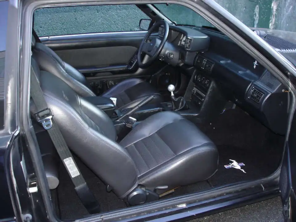

Here my 88 with a 90-93 black dash setup.
Oem 88 tilt column, and using the 87-89 column trim. However, I also have the 88 gauge cluster pod, so that might make the fit a little better than a 90-93 gauge pod

by cluster pod, you mean the gauge shroud right? from looking at your pic, it's the same as mine except it's got the cutout for the warning lights. is there any other difference your aware of?
if not, i should be able to just use the column trim from an 87-89. looks like you have the knee panel piece from a 90+, everything else i planned on keeping. i can't 100% tell, but did you use that small ruffled column trim piece on your swap too? i remember there being a piece like that on my older foxes.
i just want a different steering wheel lol. the big ass column trim behind my non-tilt wheel just doesn't look right and ruins my wheel choice.

The ruffled peice gets trashed. It doesn't fit anywhere.
I'm using the newer dash and knee panel. I do not know of the gauge pod around the gauges is the same. I have not seen a 1990+ piece up close, so not sure. It might fit different around the column, or it might be the same....just without the warning lights.
My parts list is
90+ dash
90+ knee bolster
87-89 column trim
87-89 gauge pod

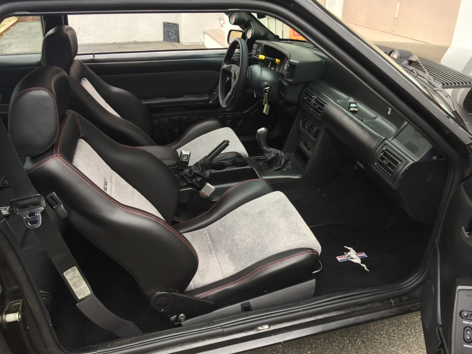

I hate to bump an 8 year old thread but you have information I need as I'm going to do the swap next month. What gauge cluster are you using? A 90-93 style or 87-89 style? It's hard to tell. The 87-89 is a flat bottom gauge cluster and 90-93 is a concave bottom. Also by gauge pod, do you mean the black housing that surrounds the cluster? Thanks!
Well, car's changed a little in 8 years from the pics up above.
Car's an 1988, originally equipped with a red dash
I'm using a 90-93 complete dash and console
90-93 HVAC controls
87-89 gauges
87-89 gauge housing around the cluster
87-89 steering column
87-89 steering column trim
Aftermarket momo wheel and hub adapter
Rest of interior is OE 1990 black with some aftermarket leather boots thrown in. Nothing is painted other than the LRS cupholder console. Really the only thing I don't like in terms of fit is where the fuse block sits. Next time I have the dash off (to do my AC reinstall) I will address that.
90-93 HVAC controls
87-89 gauges
Thanks for clearing this up for me! Absolutely beautiful interior man! What seats are those if you don't mind? Gorgeous interior again!
Mustang5L5
Mod Dude
Feb 18, 2001
43,392
18,135
224
Massachusetts
Apr 15, 2019
#13
  • Apr 15, 2019
  • #13
They are Recaro LS-B's out of a late 80's Volkswagen that I restored/recovered
Reactions: RoyalFoxLX
