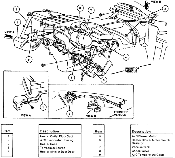

1. Remove evaporator case from vehicle.
2. Remove four heater core access cover screws, then cover from case.
3. Remove heater dash panel seal from heater inlet and outlet tubes, then pull heater core out of case.
4. Reverse procedure to install.
