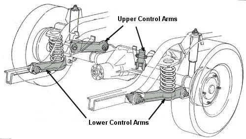

its weird cause i had a steeda rear swar bar have no clue how it broke. but cool 4 bolts aint nothing just never tired before and didnt know what to look for
very easy, 4 bolts that screw into the LCA's
you can see the two holes in the LCA's (left side) where they go, there's one bracket for each hole, one bracket (slide on) on each side has a hook for the park brake cable on it
