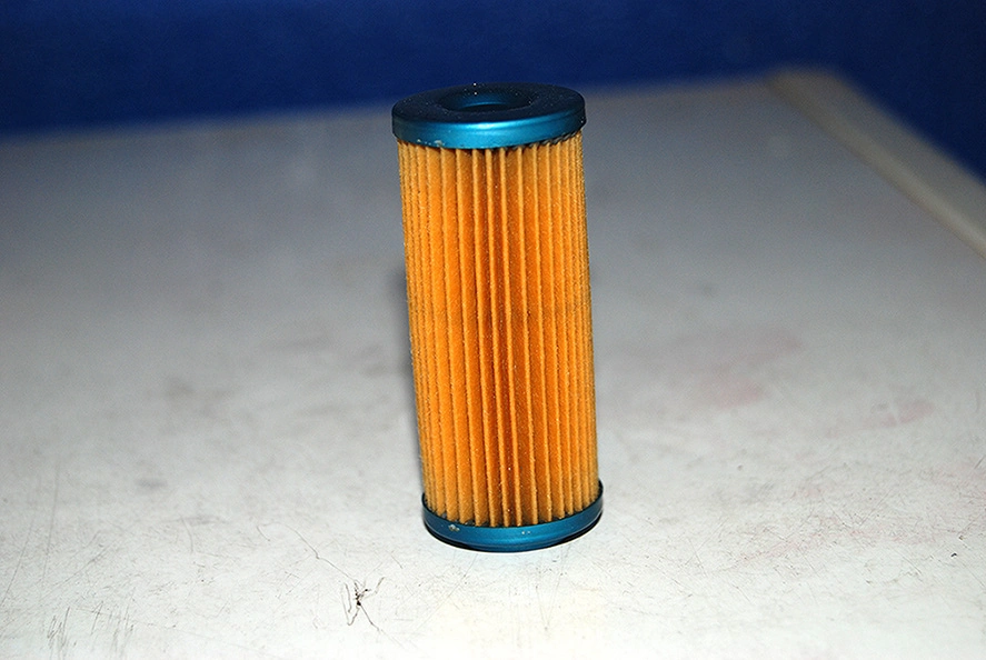

Maxpowers said:
I meant more in line with the other questions you already answered. I've heard horror stories with everything down to the fuel filter going to hell from how corrosive E85 is. Never first hand experience though.
The ones who have never tried it are always the experts.
jfor441 said:
The fuel filter gets clogged because the E85 is cleaning all the junk out of your gas tank. When you switch to E85, keep a good supply of fuel filters on hand cause you will be changing them out a lot for awhile.
Another myth. I heard the same thing as well.
Here is my filter after 1.5 years running E85.
