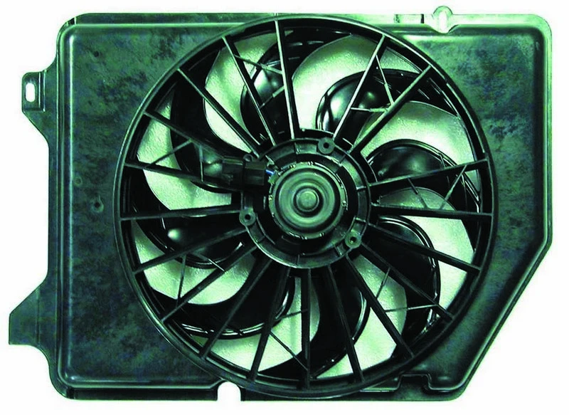

THIS STYLE?

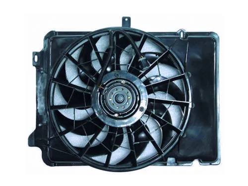

Taurus fan, dcc controller. Done
My exact set up. Works great, looks stock. And yes, it's the second fan posted that you want.
Had to get custom with my mounting options, but you'll figure it out. I was even able to retain my stock overflow bottle.
Another option is the V6 Ford Contour/Mercury Mystique/Mercury Cougar dual fan.
Pretty much takes up the whole radiator, but provides all the cooling your could ever possibly need. I run one on my 5.4L F150 and it works like a charm
Taurus fan- either one from the 3.0 or 3.6 will work, FAL 33054 Variable Speed soft touch controller. The DCC is nice but expect a month to wait for it. Other fan choice is the MKVII. I've used both- you need to trim more off the MKVII to make it fit, especially with a blower.
I'm also another happy user of the Taurus/DCC setup. I trimmed the fan shroud down so it sits flush with the radiator. When you hook up any kind of controller, use the high speed wire and not the low speed one.
