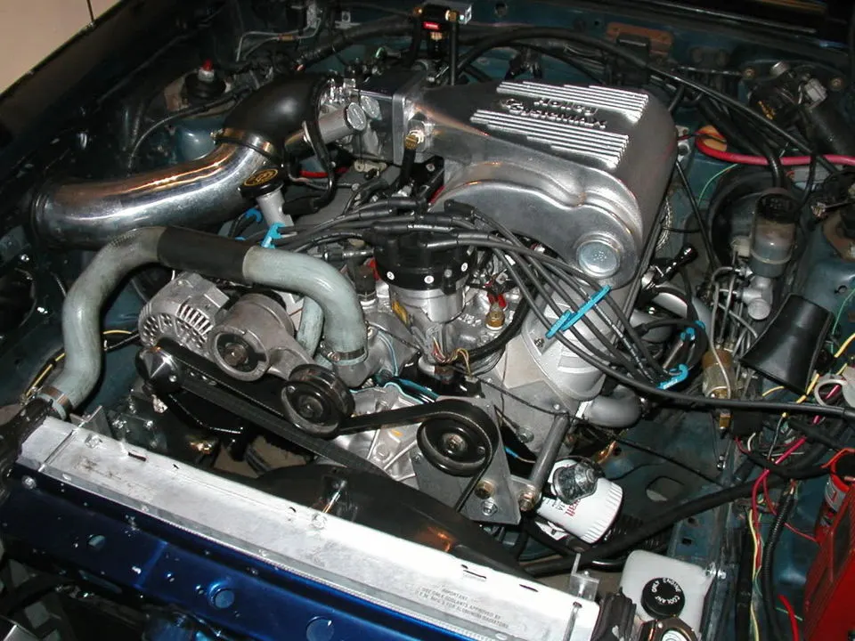

Here's a picture of mine:
Good luck!
Dean

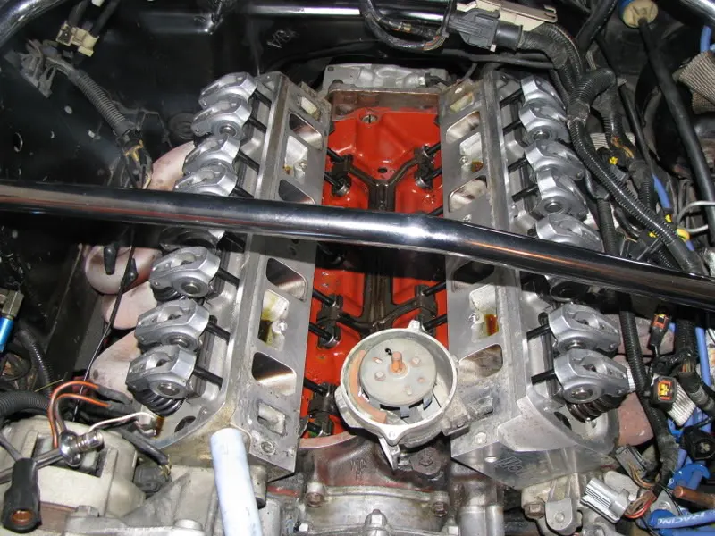

Yeah I meant them not fitting over my roller rockers. I really don't doubt they will fit under the intake without any spacers. They definetely do not clear my rockers without any work to them. The height seems ok, its the inside width. They fit down onto the head, but about 1/4 too low towards the headers to line up with the bolt holes.
I'm almost done doing some clearancing and will post up if it helps. It has taken forever. I finally found the right combination of tools....a recipricol saw with a metal blade to cut down the length of the boss's....and a dremel to grind down the extra.

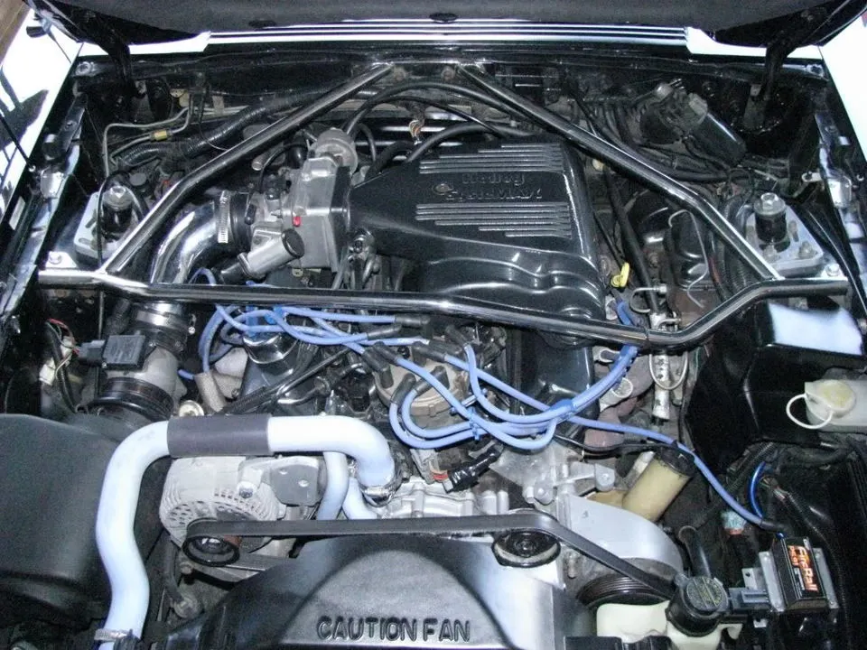

This is what I'm working with. The strut tower brace offers very little clearance for any spacers...between that and the hood thus I'm trying to make stockers work.
