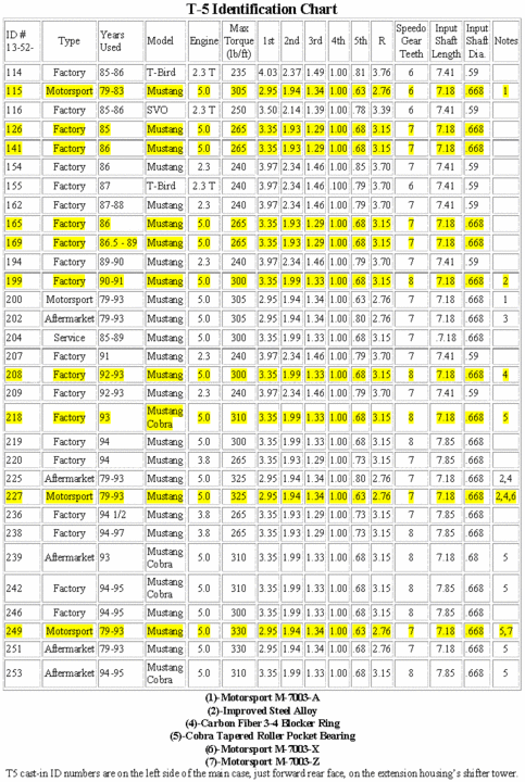

Table courtsey of Tmoss & Stang&2birds...
Now that you have specs, got out your micrometer & reasure the input shat diameter.
3.97 to 1 is a 4 banger :( . The V8 is 3.35 or 2.95 to 1. You cannot swap input shafts between 4 an 8 cylinder trannies, they will not mesh. The pilot bearing on the 4 is .59"(15mm) and the 8 is .668"(17mm)...or just look at the nice chart above :) .

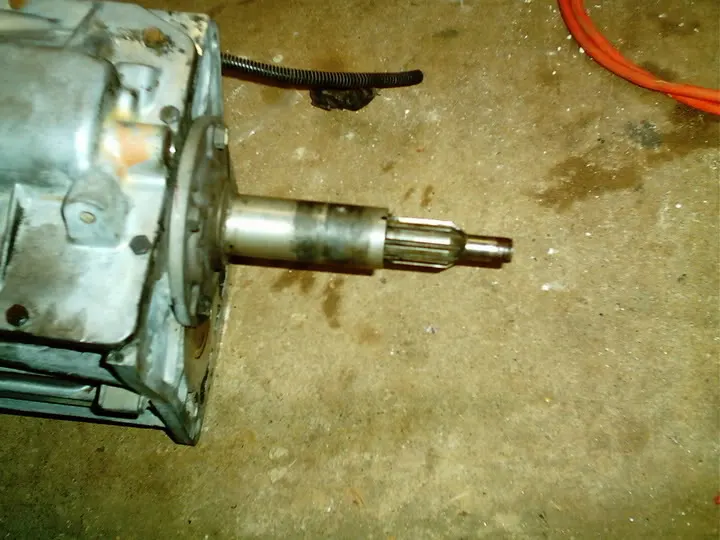

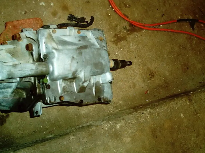

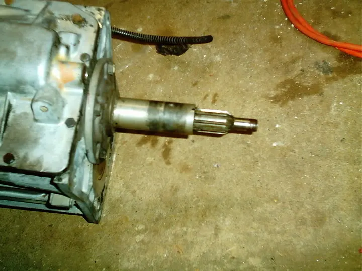

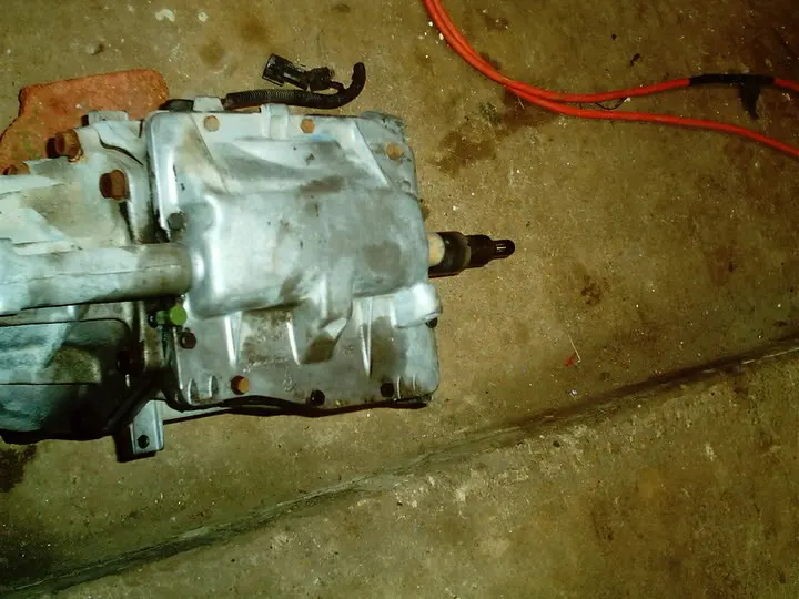

Ok,
There is another wierd thing on the trans..There is this little green plastic cap/tube on the top of the housing.. Please see pics. I have not seen this on another trans. Does anyone have one of those?? I do not know what year this was out of as the shipper told me it was out of a 1993 5.0 Mustang which seems like a lie??

That green tube is the vent. The bearing retainer looks pretty shabby aswell. I am currently running a 4 banger tranny, with great success, but it seems like alot of work just to put an inferior tranny in your car. I'd wait till you have all of the right components.
