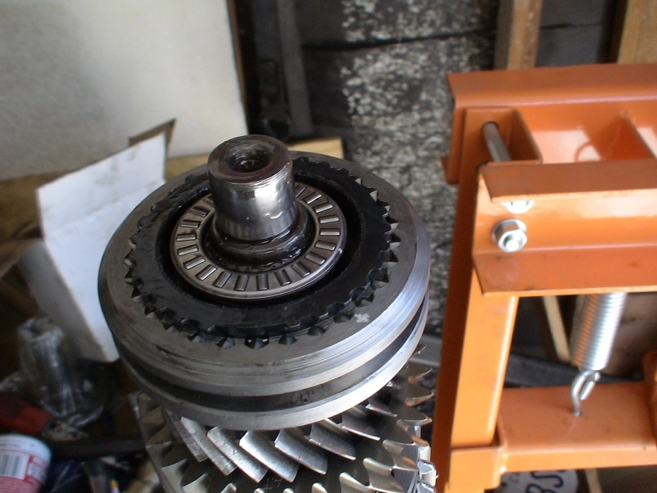

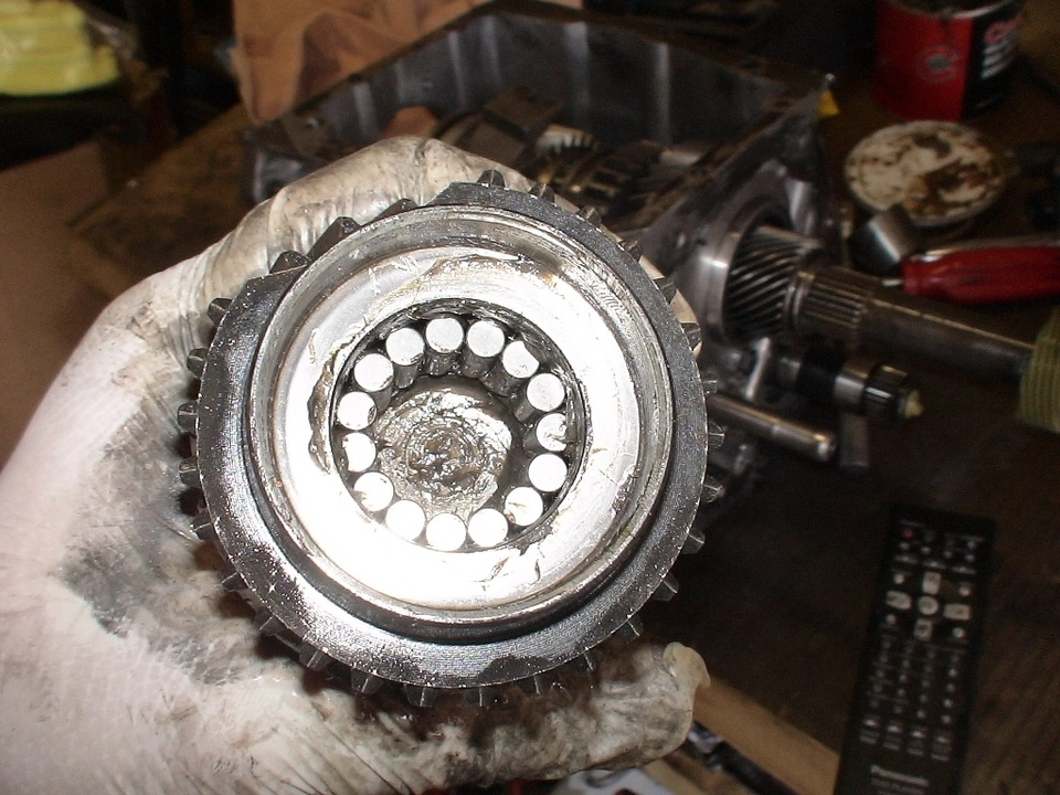

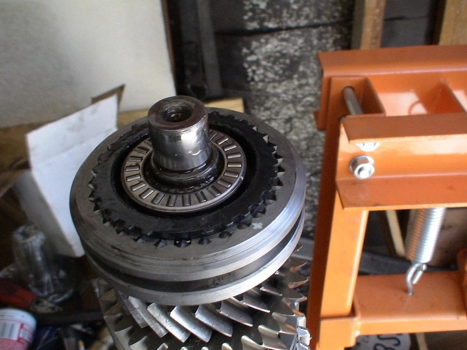

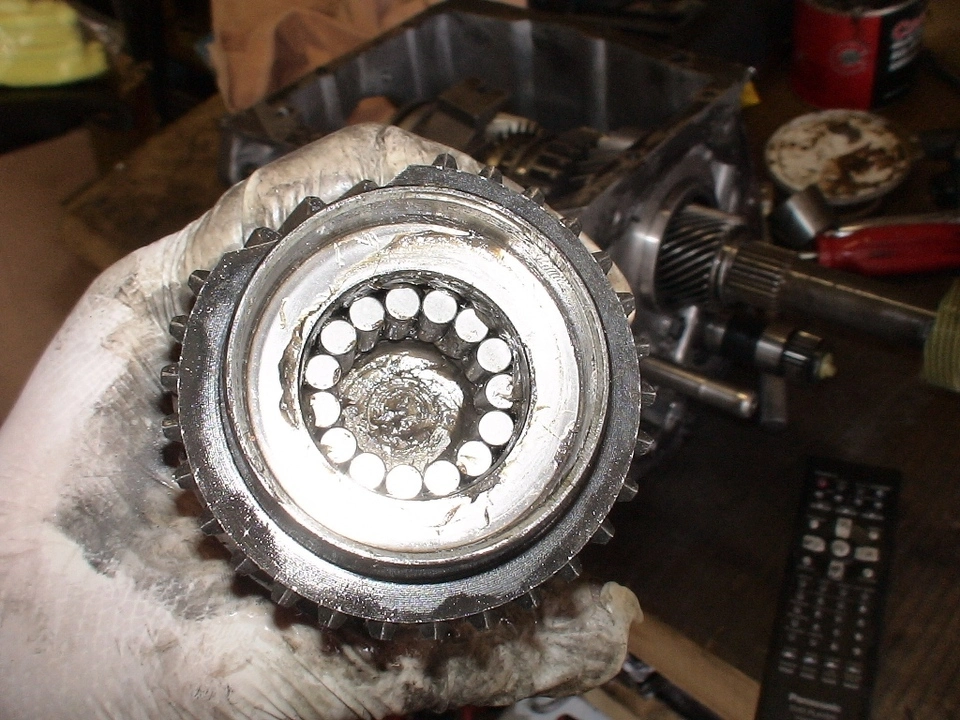

The whine you're experiencing is not coming from the cluster shaft, it's coming from the insert bearings on the end of the mainshaft that fit into the end of the input shaft.
Since 4th gear is actually on the input shaft, these bearings allow the input/4th to spin independently of the main shaft that contains the rest of the gears.
when you're in the other gears, the input/4th is spinning at a different rate that the mainshaft is spinning. When you shift into 4th gear, it locks the input/4th gear into the mainshaft and the two spin 1 to 1 together. When this happens the bearings between the two stop spinning since the two units are locked into each other, and your whine goes away.
What this all means is that you're chewing your mainshaft tip up, and by the time you pull it out, you'll need a new mainshaft, which is fairly expensive. Places like hanlonmotorsports can re-tip it for around $75 which is a good way to go. It may not be too late to save it, but if it's whining, then those bearings are already chewing up that mainshaft tip.
this is the end of the mainshaft. here you see the 3/4 slider which engages 3rd or 4th gear. The tips is what i'm referring to, and the input shaft slides on top of this tip, and the bearings go inside the end of the input shaft.
this is the end of the input shaft with the bearings in the end. You wouldn't believe some of the chewed up mainshafts I've seen coming in
