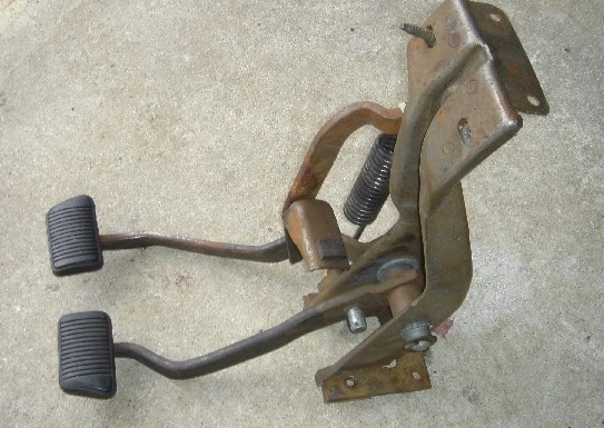

3) Pedals: Purchased these last year.

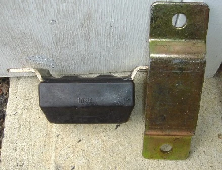

6) Tranmission Mount: This rubber mount is brand new and came with the trans. Can I use this with the new crossmember that I am getting?

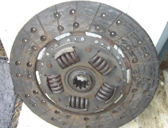

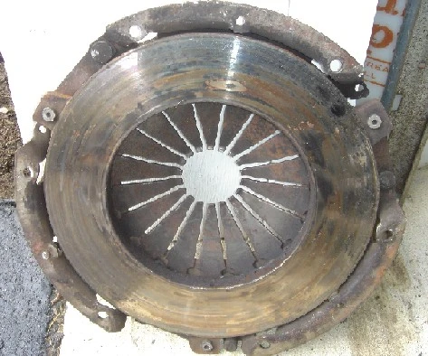

Here are some pictures of the parts.

personally i would also replace the pressure plate and clutch. the pressure plate looks heat scored and the clutch definitely is showing scoring also. it will never be easier to do than now since it's all apart.
How much would a decent stock replacement pressure plate and clutch go you think? I don't have an engine that is modified or pumping out enormous power.
How much would a decent stock replacement pressure plate and clutch go you think? I don't have an engine that is modified or pumping out enormous power.[/QUOTE]
it's not that your engine is putting out a lot of power but i'd hate to see you put in worn, used parts that are the most important part of this swap. you're probably looking at @ $200 for some quality parts. imo it will be money well spent.
