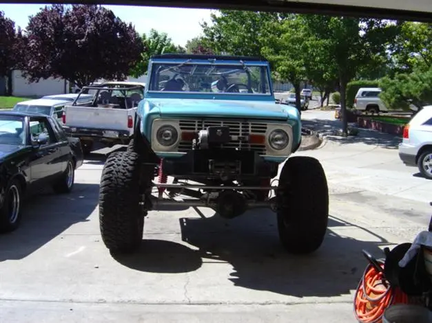

I am going to work on it today and see how it goes. I'll shoot a pic also as requested.

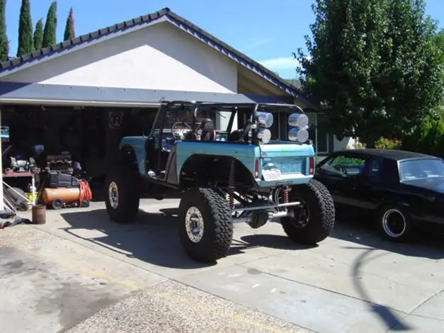

Here are a couple of pics too.
Mark
