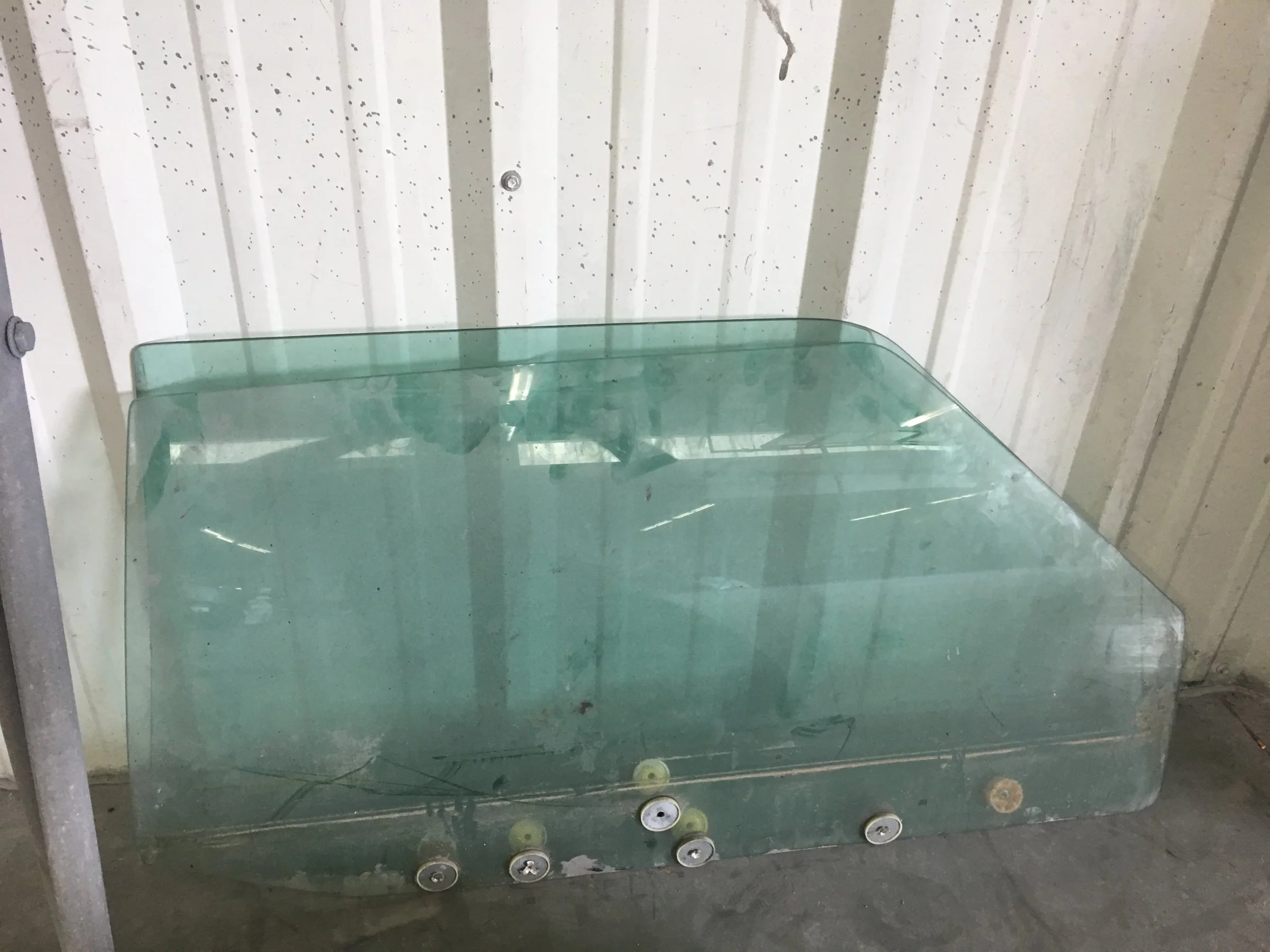

Ok guys, for some reason I could never find how they were different.
Now I've torn down my driver's door I can compare to the glass from the passenger car door (convertible donor).
The one in the back is the t-top glass, in the front, convertible.
Now we know.
Windshield is at a slightly different angle on the convertible body than it is on the coupe or hatchback body, so that alone would make the leading edge of the door glass a different angle. But then there is the height difference in the glass. And lastly the lower trailing corner of the glass is also different.
