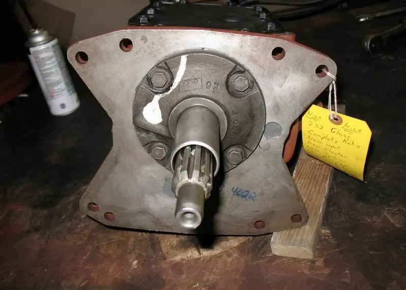

Just to add a little to D.Hearne's post. Yes the earliest toploader has a unique bolt pattern vs the later bolt pattern. Luckily the 66' and up toploaders are drilled for both patterns. This allows them to be used on the pre 66' cars too. Here is a pic that shows this:
The inner-most bolt pattern fits the early year cars.
