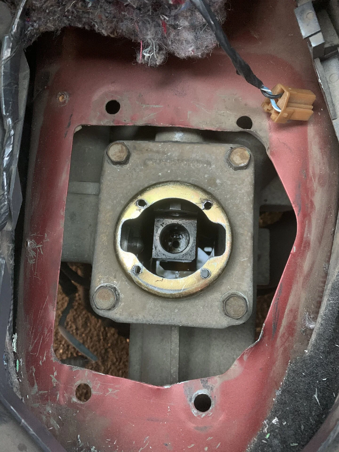

Can any of you guys tell what transmission is in my 2002 4.6 mustang by the looks? As you can see my short shifter came off the transmission. And I recently went ahead and bought a short shifter that would fit t45/t5 overdrive and noticed I bought the wrong part for my transmission. And I can’t tell what I have. I bought this car from the owners friend and he said he didn’t know about my car but he knew the transmission was a 5 speed but was worked on and now it a 6 speed and revers grinds putting it into gear Sometimes. Please help!
