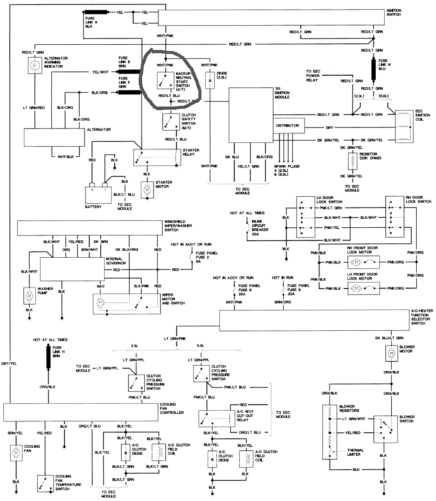

got your pm i circled what needs to be bypassed in the schematic....you can see the wire colors....but i would do this just to see if it will crank and not a permanent thing...let us know the outcome...

1 final question, when i cut the white and pink wire to the red/light blue wire should i leave the plugs in the neutral safety switch on the side of the clutch pedal, or should i leave them out or just one out or what? I shiuld be good after this!!
