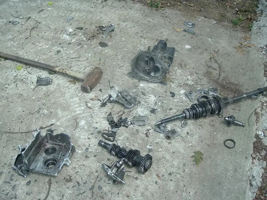

Lol perfectly good? I drove all the way home in 4th gear. Only could go in the garage once because it had no reverse =D
(gear to the left)

Felt I need to give some of the pain back that it gave me.
I made a tech thread on duggerracing.com "How to properly disassemble your Borg Warner T-5 Transmission", with all the pictures of taking it apart with a slege hammer, grinder and pick axe, and it got stickied in the tech section lol.

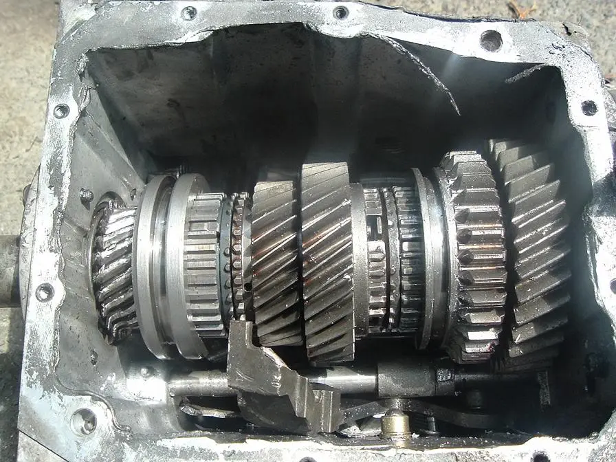

(gear to the left)
Still got the parts. That 3rd gear still looks fine.
