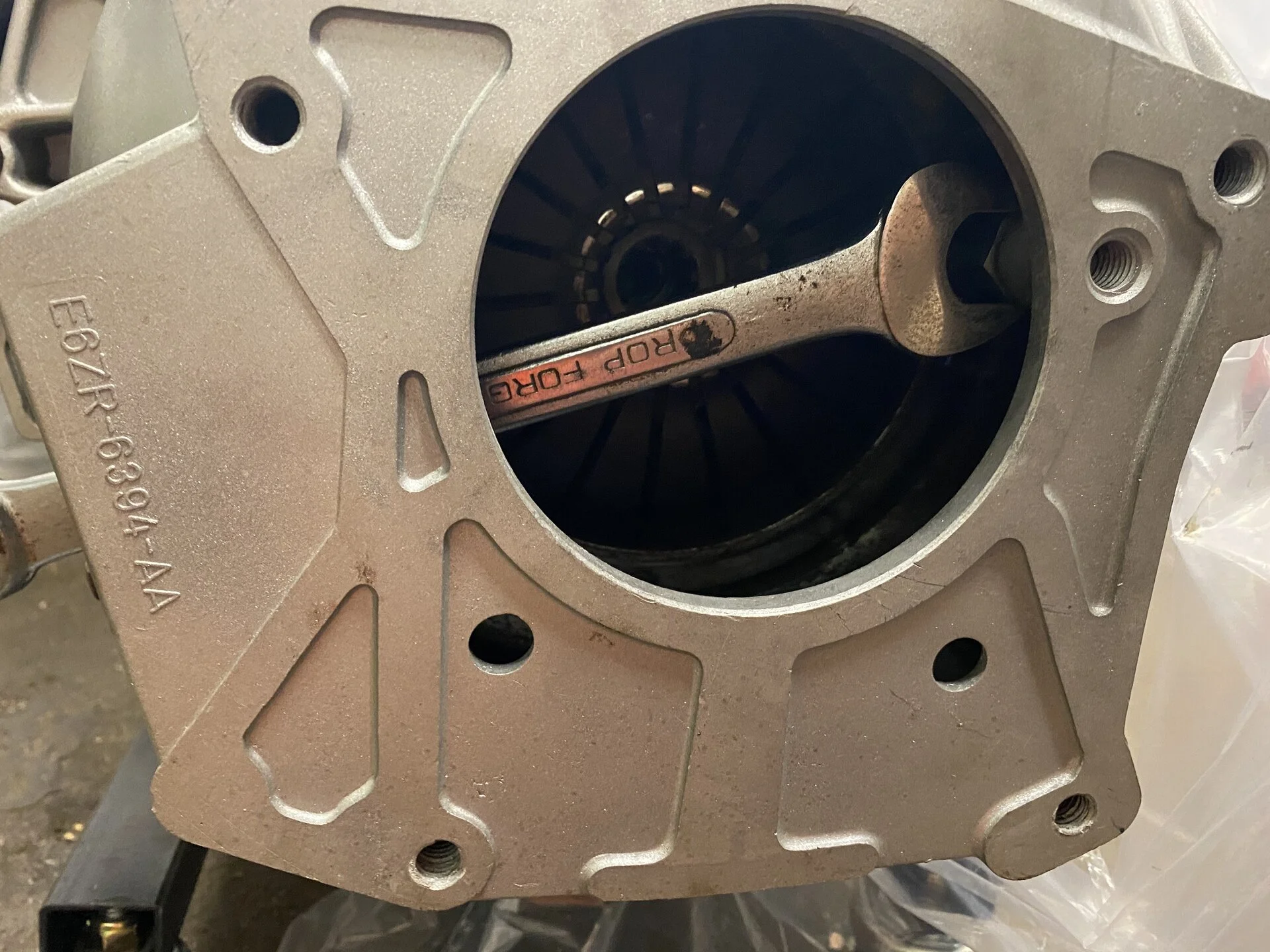

I mean you could, but it's a tight squeeze to get your hand and wrench in there. I have an engine with a bell on a stand and I tried to get my hand in and couldn't. It was close.

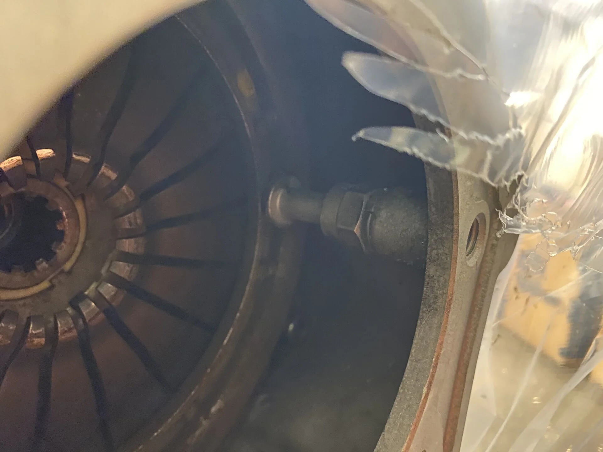

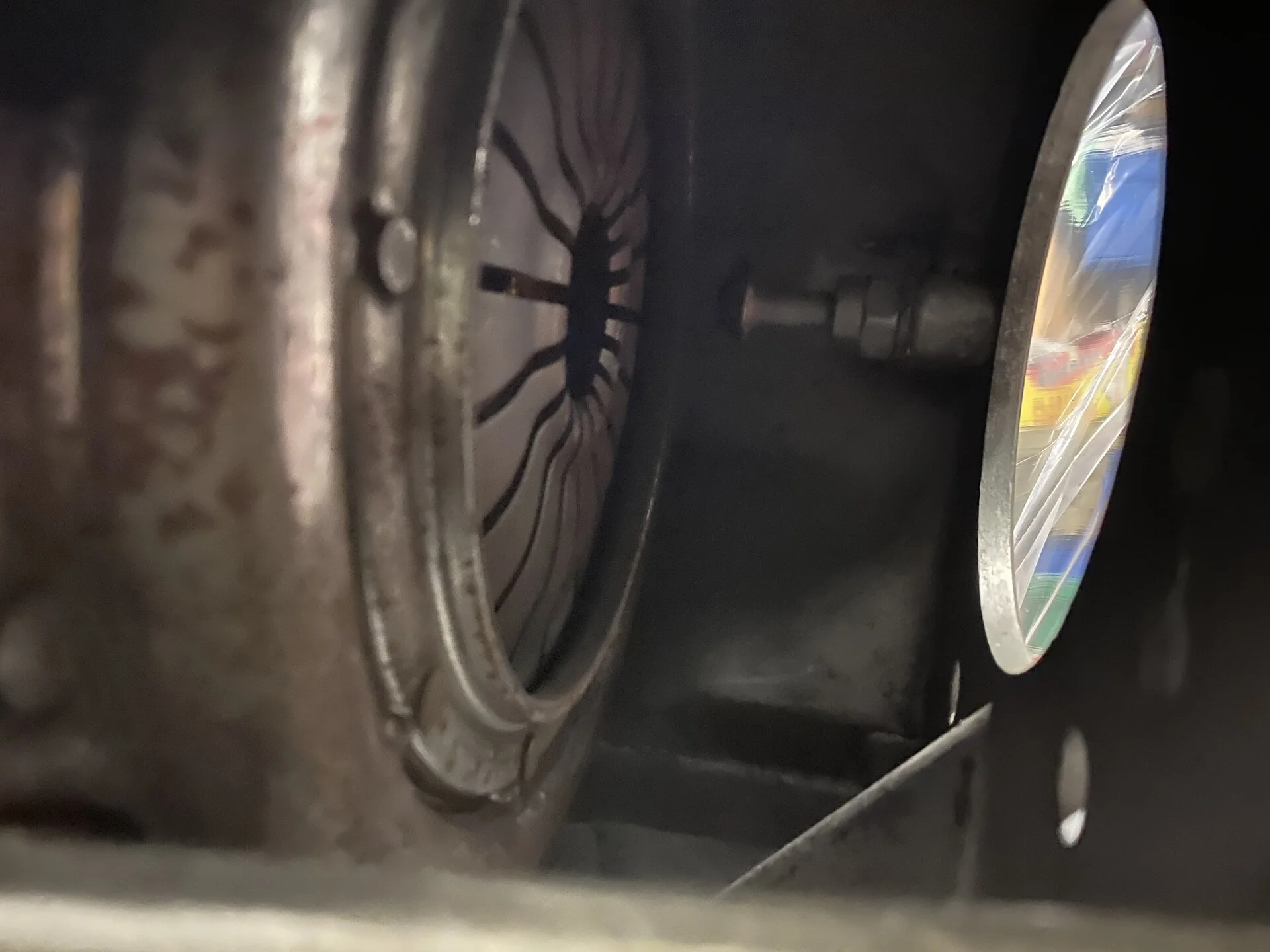

I’ll see if I can get a pic later. I can check on this. A little different but should give you an idea

Not sure your getting this out without removing the bell. Obviously there are differences between the 3.8 and a 302, buy it looks like the pivot would hit the pressure plate as it backs out.
I also couldn’t get my wrench on it. Would need to cut a wrench down to use on the pivot.

Wow that does look really close . Well if I have to take the housing off then that's what I will do. I know I also have to get the back of the engine where the o2 sensor connection is. It needs to be replaced. Thanks for the pics, wish I had a 5.0.
