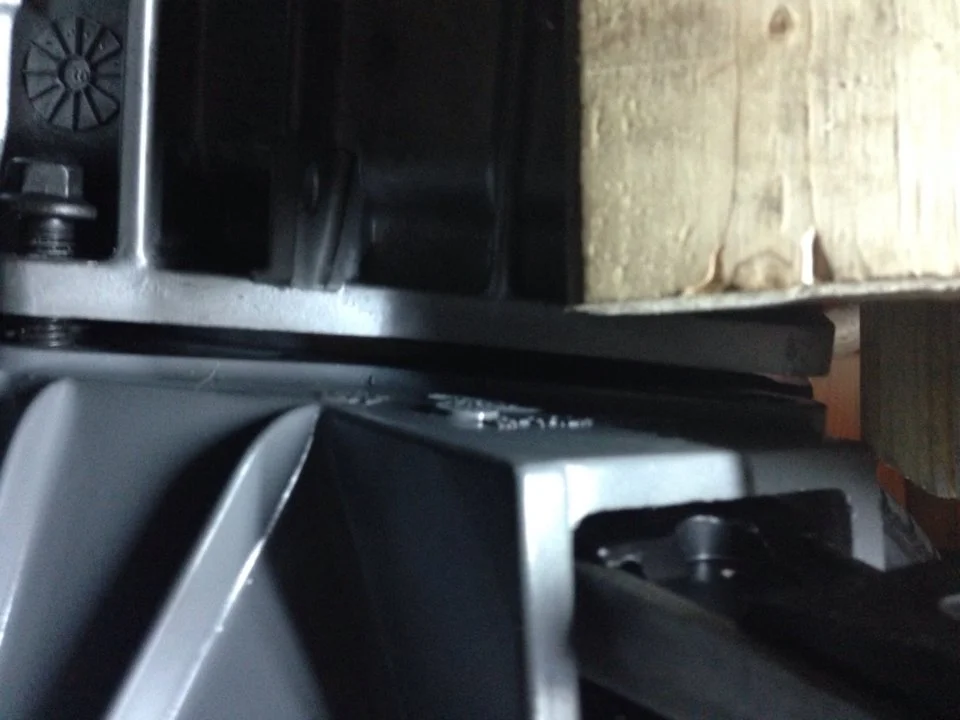

Was the tranny fully flush with the bellhousing when you tightened the bolts? Or did you draw it in a little bit? I know you shouldn't do that at all cause it'll cause damage
It's kinda hard to tell but this is where I'm at right now. It's soo close to being there

I haven't yet nah, I got tired late last night and called it a night. I started up on it this morning and got it a little closer put in all 4 transmission bolts and finger tightened them a few turns then wiggled it around and tightened a little more. I don't get why the bearing retainer won't go into the bellhousing I test for everything before I installed it and it went in snug. Should I sand some of each and try again? My dads gonna stop by and gimme a hand tomorrow with it if I can't get it tonight
Does it go in fine then just hit a hard stop?
Based on the pic it looks exactly like mine did with the wrong fit. Now I know its a 94 T5 in a 95.. but how about the bell housing? If it's a fox bell housing it would be the same as trying to fit that tranny in a fox.
Bellhousing is from a 94 gt as well. What did you have to do to make it fit? I noticed going under from the front of the car the tranny was a smidge crooked but that didn't do anything. I'm debating pulling it out and taking the bellhousing off and attaching it and installing it. It can't be that hard
I had to replace the input shaft on the tranny. My point is that just because it's from a 94 doesnt mean it IS a 94. I'd recommend measuring the bell, and make sure its the right one. I dont know the measurements, you might have to search around a bit.
The other thing you can do (and everyone will now freakout) is use the bolts to gently pull it in. If it gets HARD to turn, stop, its probably the wrong fit. If it goes in OK then you should be good.
