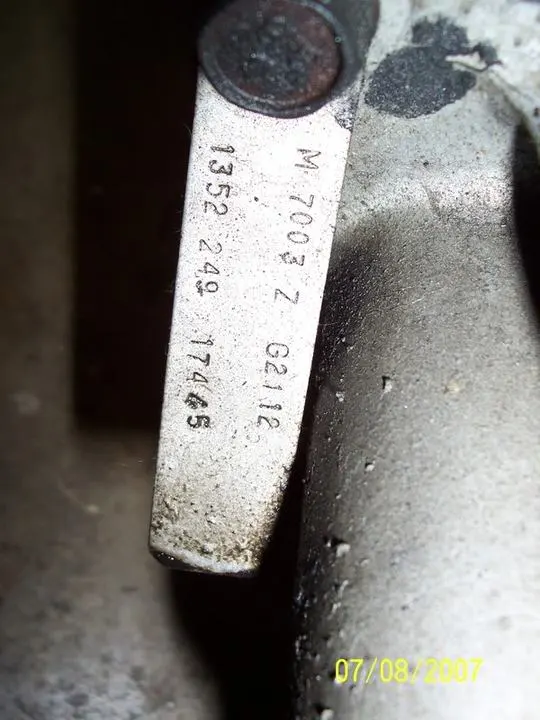

T5-Z trans question.
Not sure.
I know 1992-later T-5's do have a Reverse synchro, but it may be Cobra only.
Is the tailhousing part number 1352-066-919??
If it is, then that is the part number for the non-synchronized tailhousing. It's not compatible so if it has the reverse synchro it will have a new part number

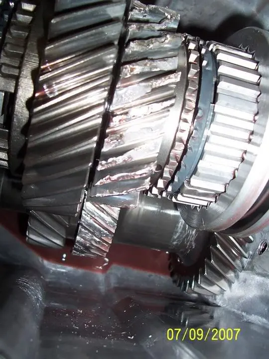

ya it was. i was racing a new 6.0 GTO. when i shifted to 3rd all i heard was this loud ass grind and my motor went to 8000 rpm. i figured i just missed a gear. but i slammed it into 4th (already doin about 60mph) and still tore him up.
after that tho it didnt make too much noise until came to a stop and put it in 3rd, lol.
