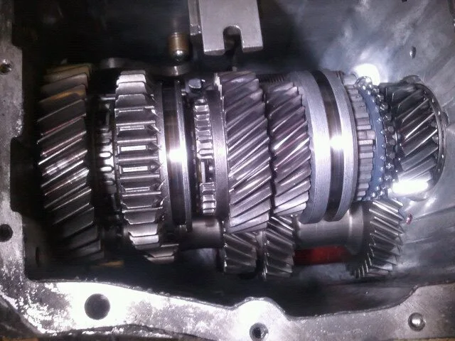

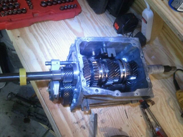

I bought a T5 from craigslist a few years ago and am just now getting around to gathering the other parts necessary for the swap from my c4...here are some pics of the internals, i just took it apart tonight to see if it would need to be rebuilt first, looks like i got lucky...one question though...the main shaft has play in it...i think its just because the tail housing is off of it, can anyone confirm thats why there is play in it...

I suggest you find out what class this T5 belongs to. You don't won't to spend money on an inherently weak T5 version. As far as the "play" goes, is it lateral or perpendicular to the case? Check the rear bearing and it's retainer. Could be the "retainer" is held in-positon by the tail stock. But again, research the case numbers to determine what it was designed for. You don't want a 6 banger being used in a V8.

It is supposed to be from a GT but the tag is gone...anyway to tell besides the tag?

all of those gears look very nice. no chips or burrs.. how do the blocker rings look? how are the dog teeth?

From what I can tell all of the internals look great...I think its been rebuilt before because the I'd tag ews gone and it had the black gasket stuff on it rather than an actual gasket, idk, maybe that comes from the factory that way?

I was able to determine its from an 88 GT, 265 ft lbs...not the best t5 but enough for my application...
