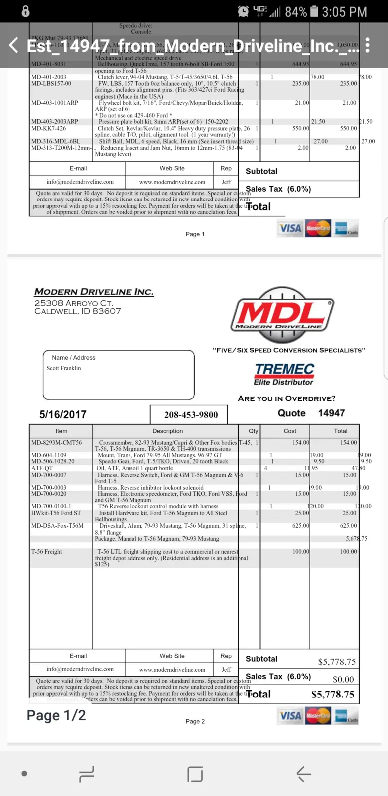

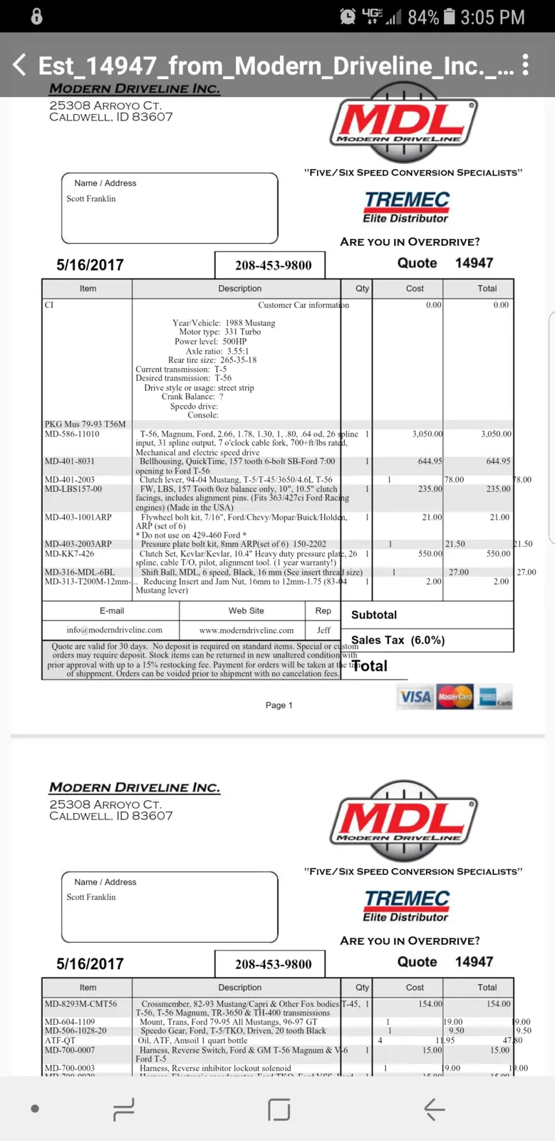

T56 seems like the ticket. Only thing is i rarely see any highway action...mainly alot of country/rural roads, but i suppose the extra gear doesnt hurt being there. Not sure what rear gear id go with yet...i know with the t5 i hate my 3.73s...1st and 2nd are basically useless...What kind of price for all the parts and a good clutch for the street? Can i still use my factory speedometer? The shimming makes me a little nervous ad ive never installed one before and dont want to mess up something so expensive but ill read ALOT before tackling it like i always do.
I'd guess any T56 magnum setup with a twin disc clutch is going to cost about $6000 or so.
Browse D&D motorsports website. I don't think their prices are the best, but it's a good place to start browsing and learning.

This is what a full fox t56 will cost without a bunch of upgrades

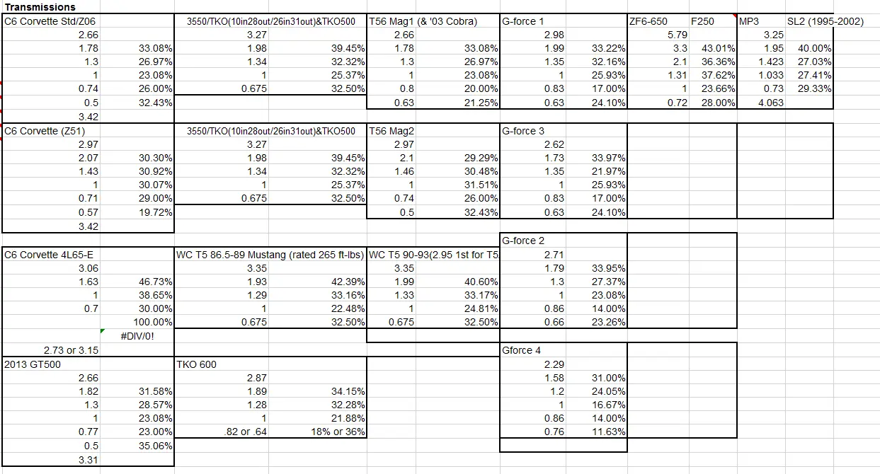

You mentioned that 3.73s were useless in 1st and 2nd gear. You might consider a D&D viperspec. I don't know if the newer transmissions are still made with these ratios, but the old viperspec T56s has a 2.66 1st and a 1.78 2nd gear. Your T5 has a 3.35 1st, and a 1.99 2nd (1.93 depending on year). So, that's an over 20% drop in 1st and over 10% in 2nd, and you still get the 0.50 6th gear! The only way to do a T56 Magnum with a 0.50 6th is with a 2.97 1st and a 2.1 2nd. That still makes 1st a little more friendly, but 2nd is a little less 'useable'. I personally think you should go with the T56 Mag2 listed below if you can't find an old Viperspec and if they don't offer it anymore. Here are some transmission gear ratio specs I've collected, including a lot of T56 variants. If you guys catch anything needing a correction, I'm all ears, but hopefully it helps you see what's out there.
