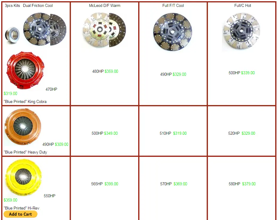

Which promotion clutch? And how do you like it?
I'm not sure I don't fully remember.
It was something I think meant for an 03 cobra (no relation to my terminator conversion, I had it before that).
When I switched to a modular engine I sold off the flywheel and Lakewood bellhousing for the proper parts but kept the clutch.
I could have sworn the rating was 700hp. And I know for sure it's yellow.
Doesn't skip a beat on a hard shift.
But the reality is that I don't love it. It's heavy on my leg and it's either engaged or it's not. There is pretty much zero slip.
One of these days i'm going to switch it out for a McLeod dual clutch, but I have to convince myself to spend $800 on something that isn't really broken or find a cheaper alternative, which won't be easy because I find more peace of mind with economizing with the best as of late.

Must be one of these, from their website. Your feedback is right on point. I have a Spec 3+ that chatters unless I'm really careful. It's not too hard on the leg, but not as comfortable as the twin-disc, not as smooth, and not as high a power rating. I was hoping to hear there was a 700+hp single disc smooth clutch.
