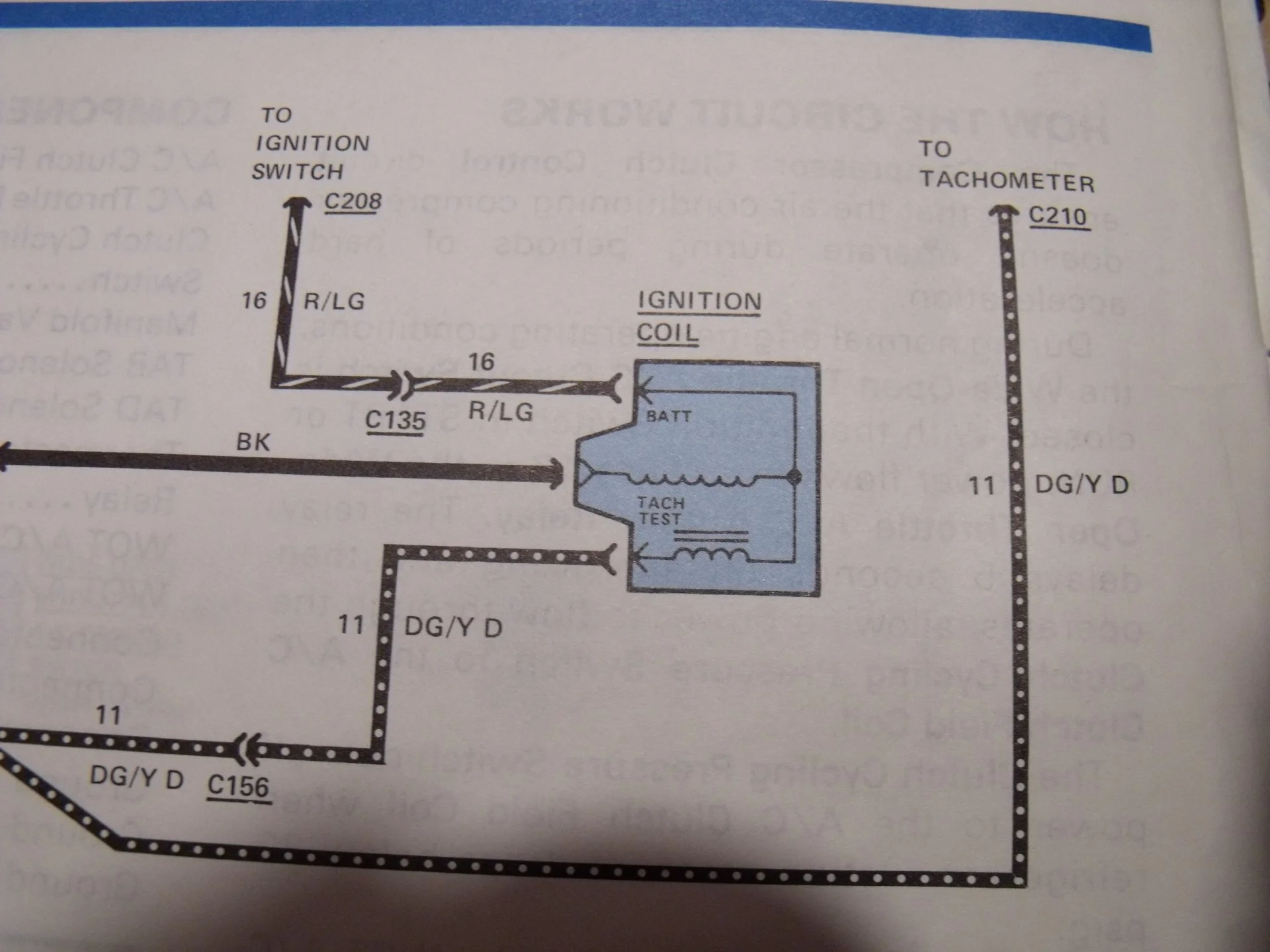

Tach wire color? 84 GT 350
Using a MSD box and Tach adapter. The cable and wires are cut off at the end of run. Fortunately harness cable in the perfect spot to easily splice.
An answer form someone would be greatly appreciated.
I just need to ID that wire going to the factory tach.

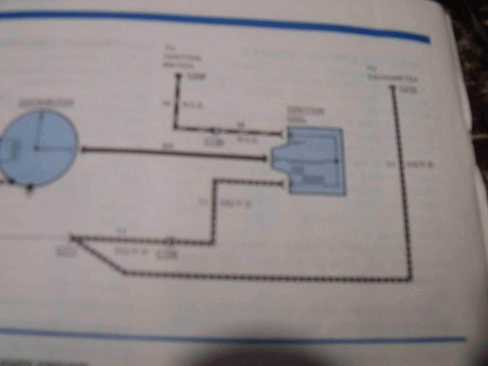

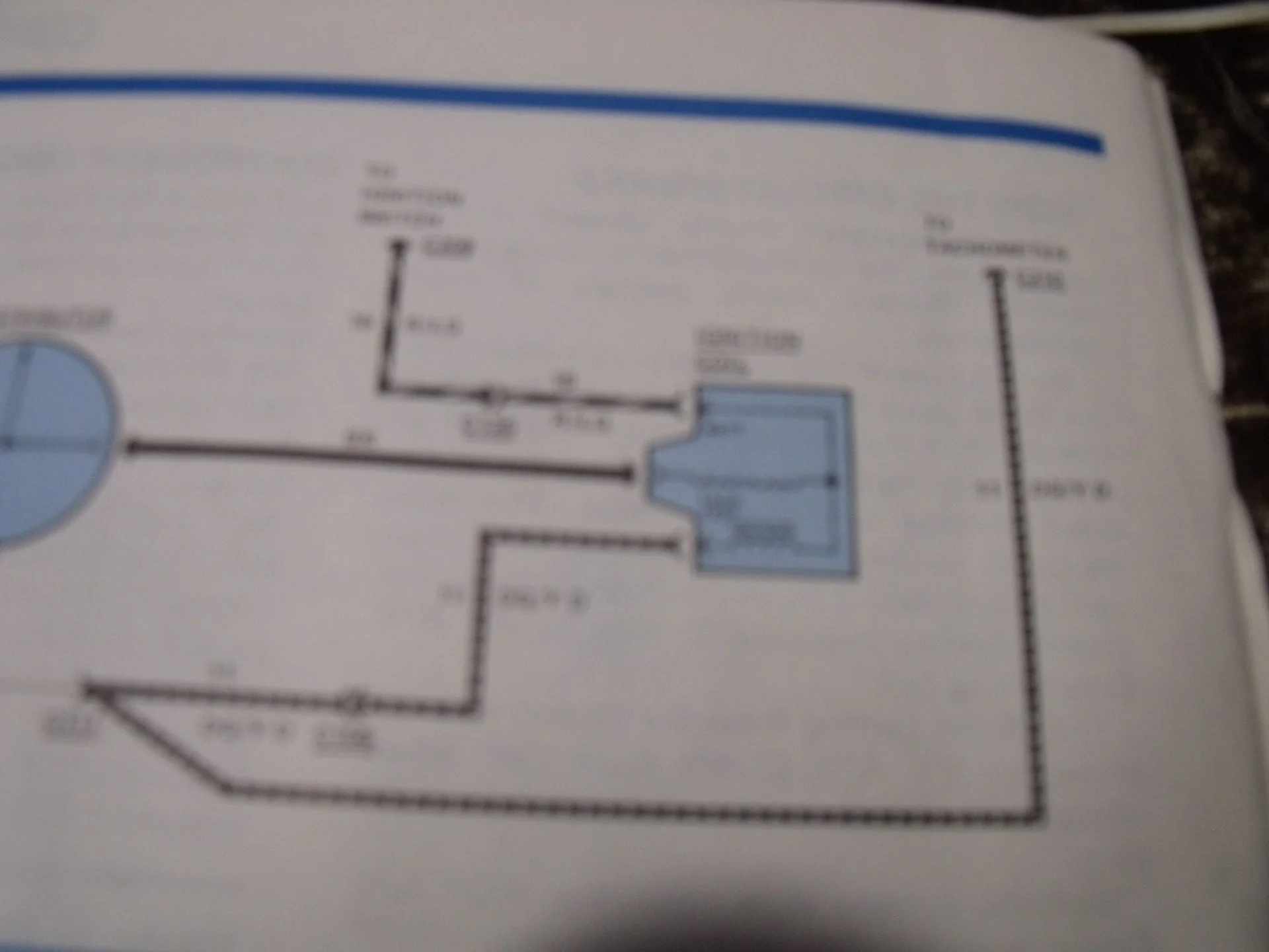

Pic from my 83 trouble shooting manual... 83 calls for a Dark Green/with yellow dots... Form the tach to the coil
