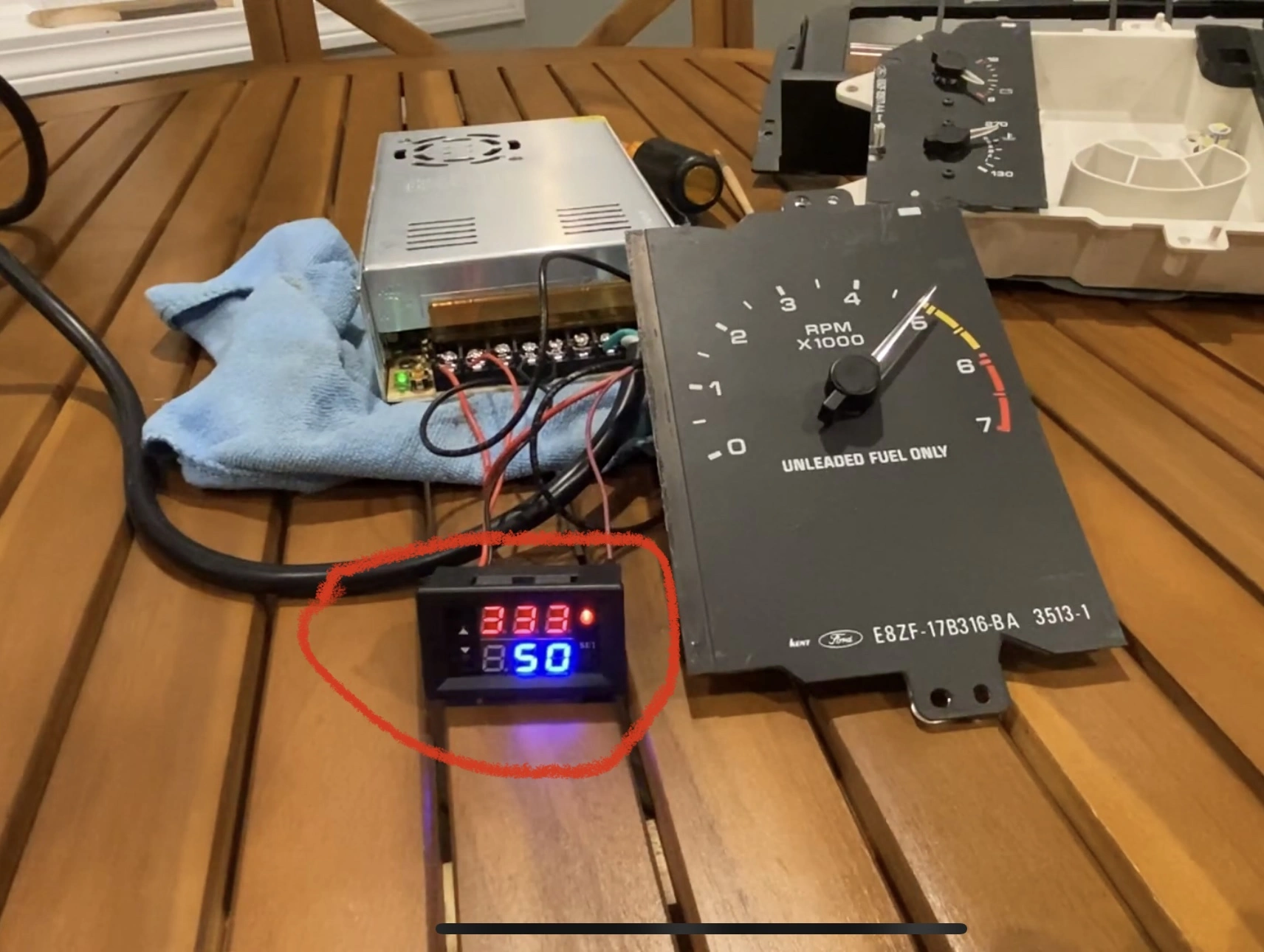

Check out this vid. At the end of the video I’m pulling the cluster apart to remove the tach. The beginning part talks about calibrating the tach but you can use this to just test to see if the tach actually works. The tach works off three pins. 12v+, ground and a signal wire. That wire is the Neg side of the coil.

Silver box is just my 12v power supply for bench testing.
The item in the link below is what I’m using to generate the signal for the tach
Frequency Generator, DROK DC 3.3V-30V 5-30mA 1Hz-150kHz Adjustable Output PWM Pulse Duty Cycle Square Wave Function Signal Generator Module https://a.co/d/dmEiPm7

This little box circled in red is the frequency generator I’m using to signal the tach.
Silver box is just a 30A 12v power supply I stole from a 3D printer I scrapped.
Tach and frequency generator need to use the same 12v power supply
