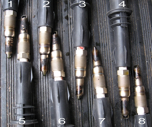

Plugs right after removal and before cleaning:

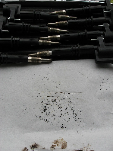

During cleaning:

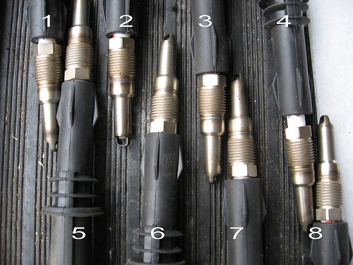

After cleaning, before Nickel Anti-Seize and re-installation:

So what happens to all the loose carbon pieces (that were between the extended tip and cylinder head) and penatrating fluid that soaks in around the spark plug. Does it drop in the cylinder when the plug is taken out. Yikes, that can't be good.
Burns off and is passed out through the exhaust valve, it's a non issue..
