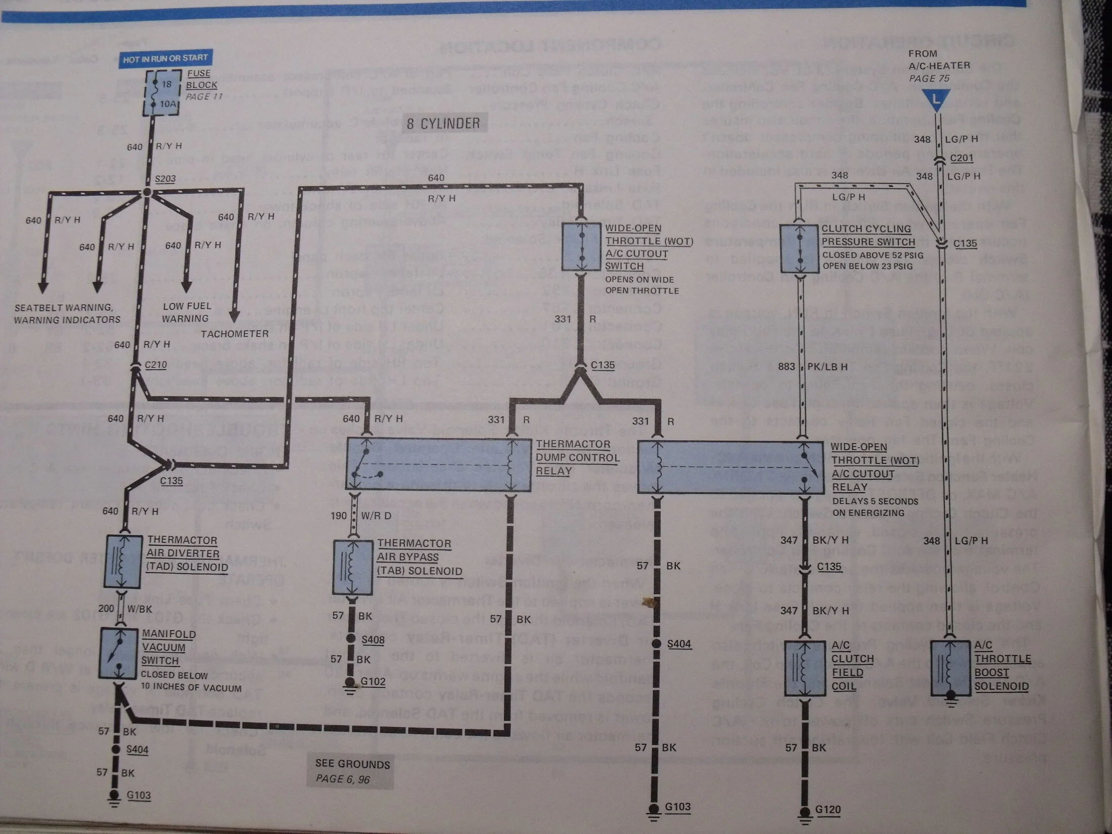

TAD And TAB hot wires are a constant
12v keyed source?

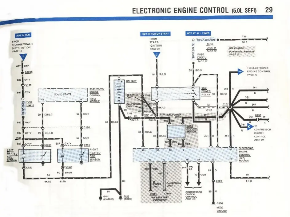

12v keyed source?
This is from my 83 manual....

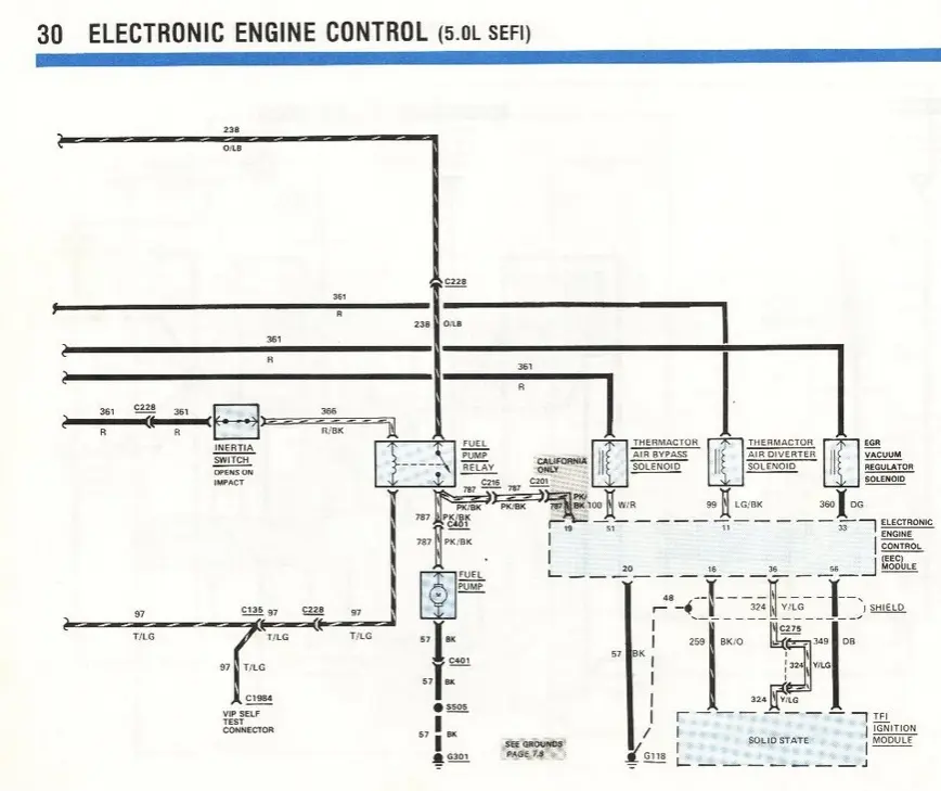

On 86+ cars, it's Key on power. It's fed off the EEC relay. Wire 361

Cool thank you, ok here's a question? Since wire #361 is powered from the EEC relay is it really necessary to use wire 361 as the trigger fir an additional relay instead of a fused direct running supply?

Depends how much current you intend to pull. The ECU relay is on a fusible link. 20g fusible link is good for 10 amps.
Looking online, an AFR controller looks to be 5 amps, but would have to see what the rating is on yours. Are you using the TAB/TAD and EGR regulator?
