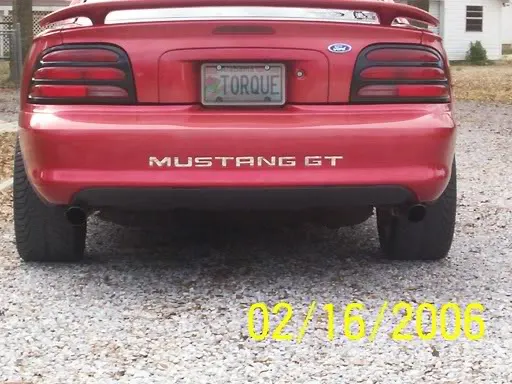

you have to remove the whole tail light and tape the red lens and spray paint the plastic bars for best results. i used krylon fusion satin black and this is what you have when you finish...
